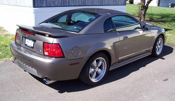

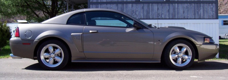

Ok, I was able to obtain the info on my suspension:
Eibach Sportline Spring Kit (between 1.5" to 2" drop)
Attached Thumbnails SN95 Suspension/Chassis Modifications-02gt-side.jpg   SN95 Suspension/Chassis Modifications-02gt-rear2.jpg
