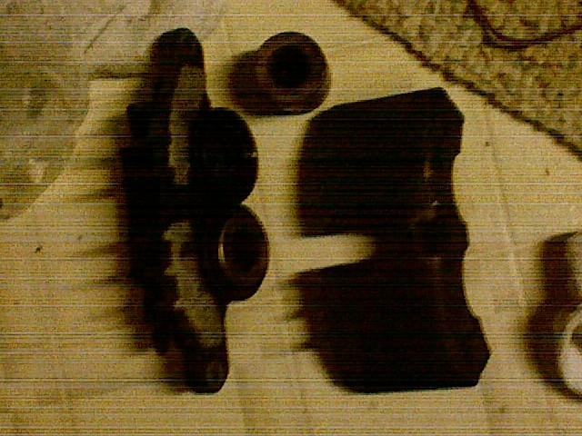

The Pic of the caliper in pieces. It cracked right along the top. Sorry about the quality picture phone.

Thats a new one.....have been using the brakes hard previously? Were there any warning signs also previous to that happening?

Have the pads been changed recently, or any work that involved reassembling the caliper? My only idea would be that something was over tightened causing the crack, and the extreme cold to hot to cold cycle was just too much for it to handle. I would assume that brakes heat up a lot faster than the engine does. A few good 25-0 stops I would assume to be enough to heat up the caliper/rotor. Glad you were already home.
Old Feb 9, 2008 | 11:16 AM
I've never seen that before. I'm guessing just a crack then, escalated by the temperature change.
