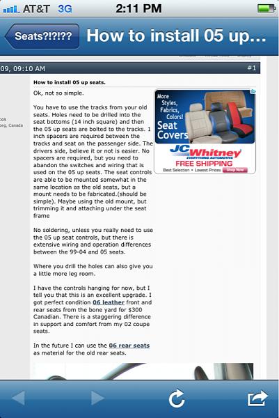

Yes the seat will work but for the dash and console wouldn't we worth it IMO
