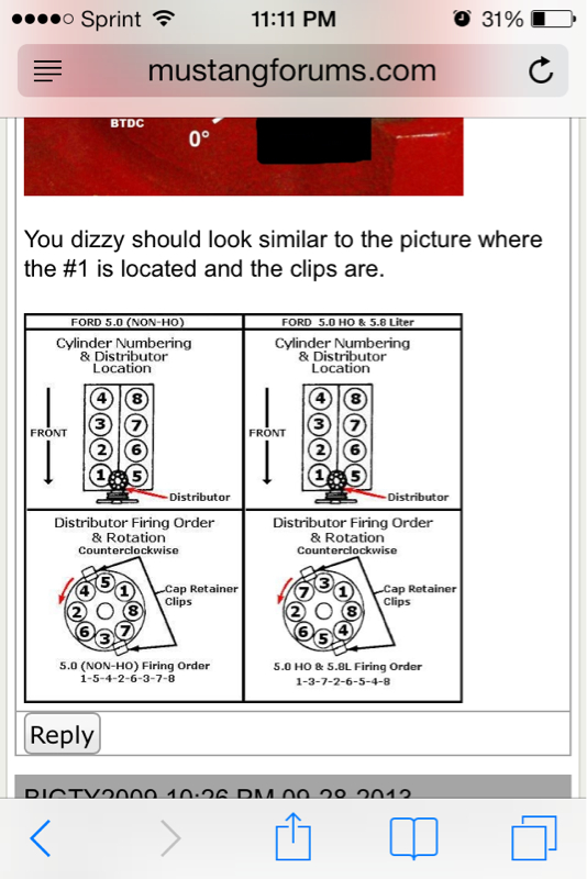

My GT won't turn on, the battery is good the gas is good, I just replaces the distributor , because my old one kept breaking the rotor inside of it, but now it won't turn over, and I'm thinking maybe I didn't replace the wires to the right spark plugs, I need help, what do y'all think it is ??

Please confirm; when you turn the key to start, does the motor turn over at all? If it doesn't turn over, it's not the plug wires.

It's sounds like it wants to turn on but it just won't turn over, it sounds like it need gas but there is a quarter Of a tank in it.. But what do you think it is bro???

If it won't crank at all, check the connections to your starter...this assumes you have a good battery.
