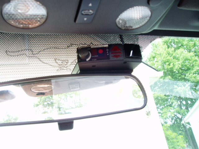

Originally Posted by AWmustang
Wouldn't putting it above the mirror reduce it's effectiveness because of the black pony and dots?
Mounted my V1 to the right of the decal and as high as I could get it, where it has a clear shot out the back window and where I can quickly grab it and put it under the seat when stopped.
Read awhile back that you do not want to mount it behind any decal that has any metallic in it....I have tinted windows (not the front ) and made sure the tint I used was just tint without anything that would interfer with the detector.
That is why V1 and Escort tell you if you have an old Ford with the instant defrost front window it will not work....metallic was used in those windshields.....
Some will say that their V1 or Escort is the best and so powerful that it does not matter, but it does to the radar manufacturers and the design engineers.

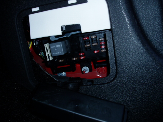

The V1 system consists of the main unit which can be powered from your cigarette lighter or hardwired in to the vehicle electrical system, plus an optional concealed display. I went the hardwire route w/concealed display, the install details of which (w/pics) are provided below.
I used velcro on the detector and the windshield to hold the main unit in place above the mirror and a bit to the right, which gives a clear shot up high to the front and rear, then I pulled out the dome light and ran the wire across the windshield header, down the passenger pillar, and into the fuse box area. The fuse box is in the lower footwell area to the right of the passenger's foot - pull off the cover, then remove the second interior cover that hides the fuses, and tap in for power. I *think* I used fuse 12 which was a switched fuse that was mounted in an easy to access spot in the fuse box. It may even have been the radio fuse, but it's really not important which one you use as long as it's switched so it powers the detector on and off when you start/stop the car.

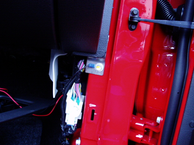

After tapping in to the fuse panel, I pulled off the rest of the lower kick panel to find a good ground. To remove the lower kick panel you first need to pull up the forward section of the rocker sill cover inside the passenger door area, then you can pull out the rest of the kick panel trim. Once that's removed you should clearly see the instrument panel mounting bolt - loosen the bolt, attach the ground, and then test the detector with the switch on and off to ensure you have a good ground and connection. You can then reinstall the kick panel trim and proceed to wiring the concealed display.

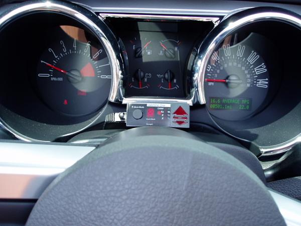

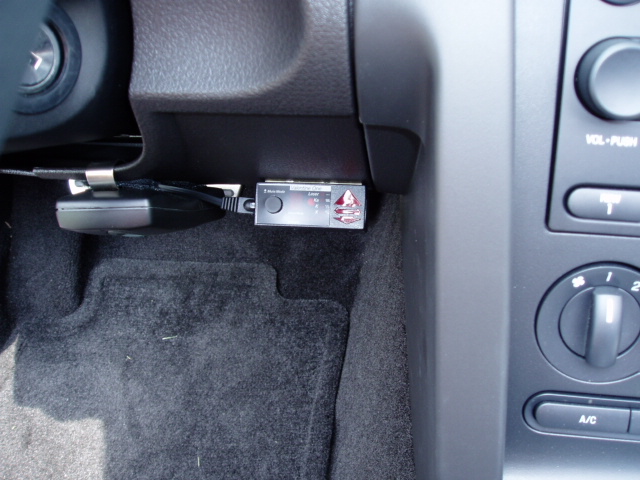

I initially installed the concealed display in the lower panel area to the left of the radio. It was well concealed, but I found it was a bit hard to notice in day light. I didn't like it because the concealed display keeps the main unit completely dark, and since I tend to listen to my music loud, I need to be sure that I can clearly see the visual warning. I later moved the unit to the top of the steering wheel under the speedo - cops (and theives) will see it if they're looking in the car, but it's easy to remove in a hurry or you could cover it up with a paper or post it note if you needed to.
Wiring from the concealed display was easy. There's a wiring harness running along the floor above the passenger's feet. After plugging the concealed display wiring into the power supply that I just hardwired, I simply threaded the cord around the existing harness, routed it behind the radio, and snaked it up under the steering wheel. Then I velcro'd the display under the speedo, attached the wire, and tilted the wheel up to hold it all firmly in place.
The concealed display keeps everthing on the main unit completely dark so that no one following can see that you're using a detector. All the warnings are displayed on the concealed display and you can mute the warning from either the main unit or the concealed display, plus w/the display mounted on the wheel it's in perfect line-of-sight while you're driving. No missed alerts in this location!

A few more pics, the last one a shot from behind showing the stealt view from back. You can still see the detector if you look, but it's a lot better than the telltale hanging coiled cord.

Well of course those dots won't interfere with radar. What they will interfere with is laser. And considering the only thing the V1 is marginally better at than the 8500 X50 is laser, I'd put it where it can most effectively pick up laser.
That's a no brainer.
