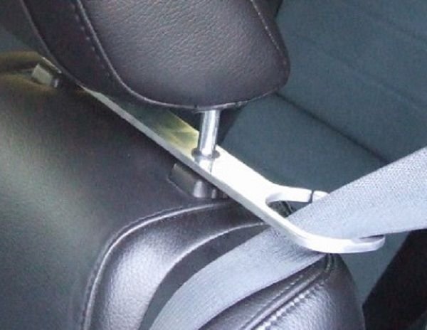

OK, not "there" yet, but getting closer. I am or was looking at something like this:
I thought about aluminum, easy to cut on my band saw, smooth edges, polish them to look like chrome. One would remove the head rests to install, use rubber grommets at two holes, include a slot to allow shoulder harness to be inserted into loop. I also have some old pieces of drop in pick up bed liners that were flat and smooth and black, it's a thick plastic, near 1/4" thick, easy to cut on the same band saw, edges are easy to smooth too and while stiff enough, they bend easy in use.
Then I run up on a thread on another sight where a fellow used late 2000s Chevy Cobalt guides and simply enlarged the holes the head rest post go through. See below.
Nice interior, it's a '15 I think, but same idea. Then I got to looking on Ebay, lots of "loops" with slots, they could be adapted to mount on a flat piece. I still have some "looking" to do, measuring, etc …. will post results when I work it out.
I've got some nice easy to work aluminum, but I like the black too? I also think the plastic ones will wear belts less adversely, if at all. I know how to get the head rest out, I did that a couple years ago to adjust them back a little bit.
