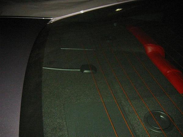

Hello Neil,
This is where I have my XM antenna mounted. No reception issues at all.

Mounted here. Rarely have drop outs.

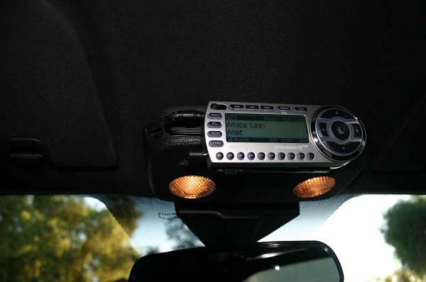

I tried posting this beforem but the system deleted my [rather long] post and I gave up.

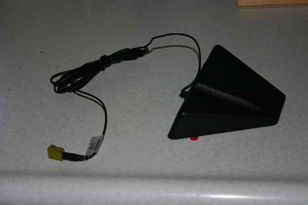

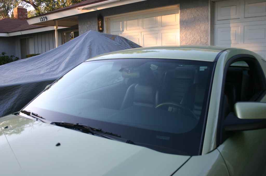

I bought the Sirius SIGMA antenna from Nissan [$30 cheaper on the internet <sigh>]. The thing mounts inside the glass right behind the pony on the windshield and you can't see it from the outside. My Sirius Starmate Replay is mounted on the overhead console and is wired in there and I use the FM transmitter and it works fine, so much so that I hardly ever use my radio directly anymore.
Mike E

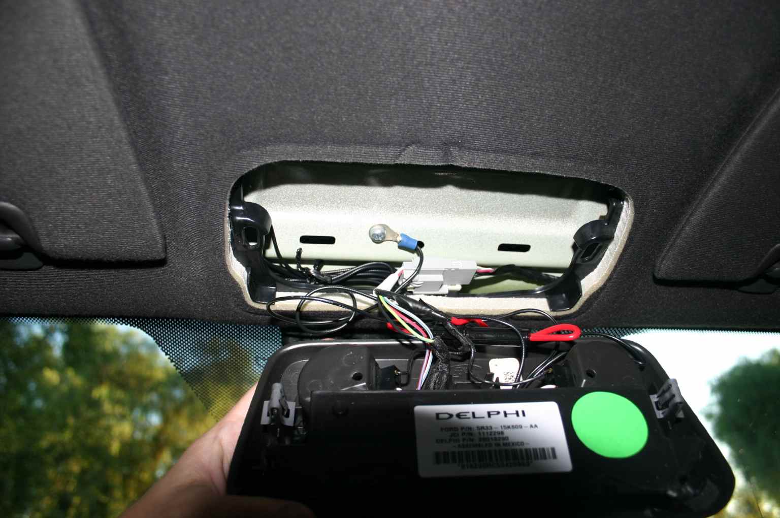

Old Oct 28, 2006 | 06:43 PM
mikeelia's Avatar
Joined: April 20, 2005
Posts: 350
Some pics... I soldered in the power to the overhead lights with an inline fuse holder I got at Radio Shack and used a sheet metal screw and eyelet to attach the ground to the roof steel... All of the antenna wire tucks into a void up there.
And I used the plastic holder from one of those suction cup mounts on the front of the console with the screws that came with it...
Mike E
Attached Thumbnails Satellite Radio Antenna Mounting Location Options-cars-sirus-finished-install-mustang.jpg   Satellite Radio Antenna Mounting Location Options-cars-sirius-soldered-wires-ground-fuse-console.jpg   Satellite Radio Antenna Mounting Location Options-cars-sirius-interior-antenna-01.jpg   Satellite Radio Antenna Mounting Location Options-cars-sirus-antenna-outside-view.jpg

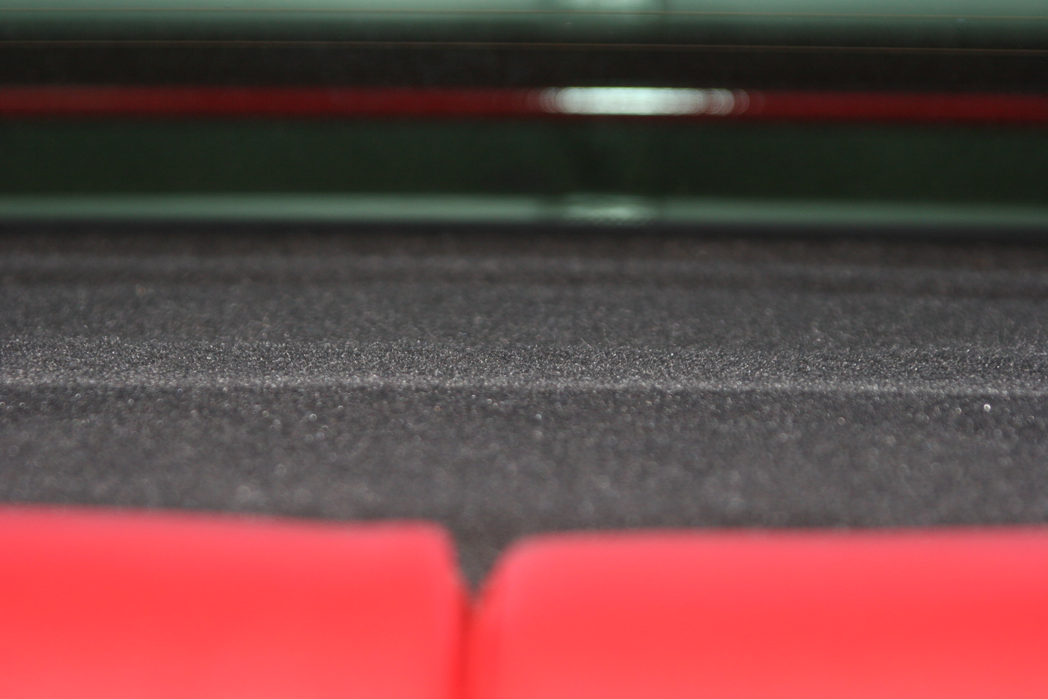

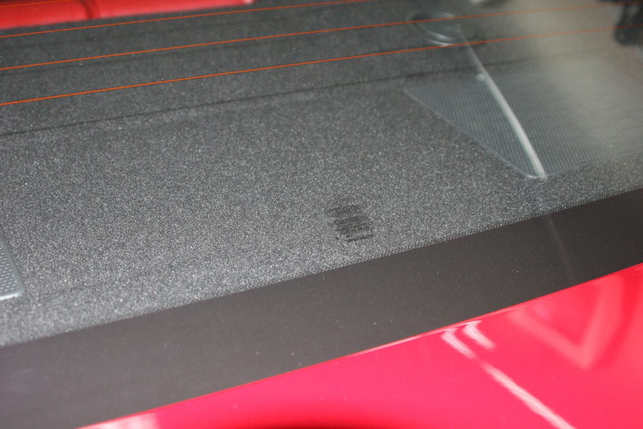

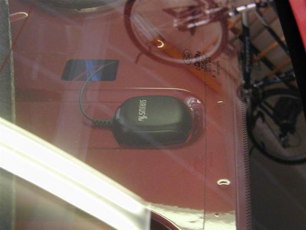

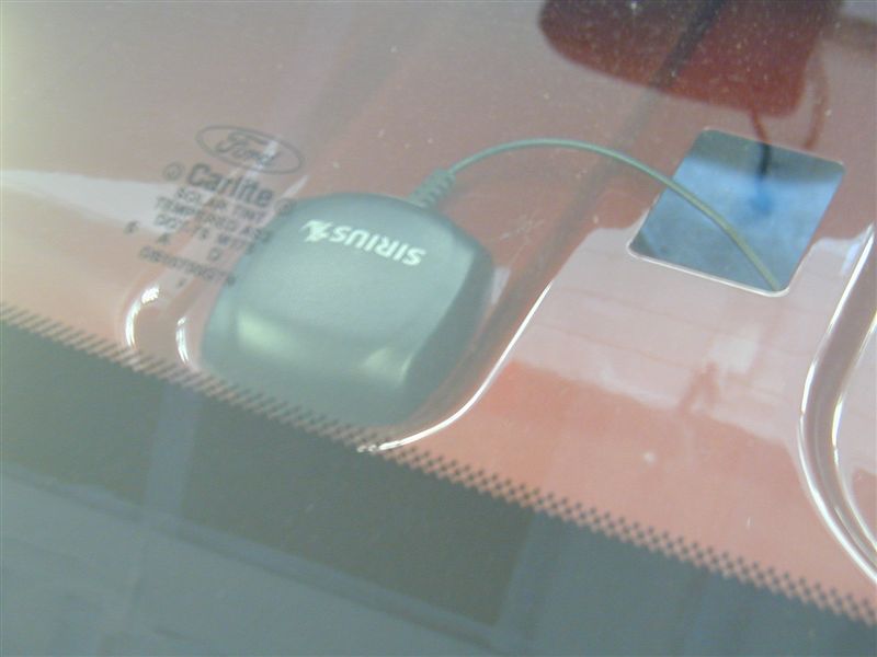

Old Nov 24, 2006 | 04:32 PM
GTEUPP's Avatar
Joined: November 13, 2005
Posts: 14

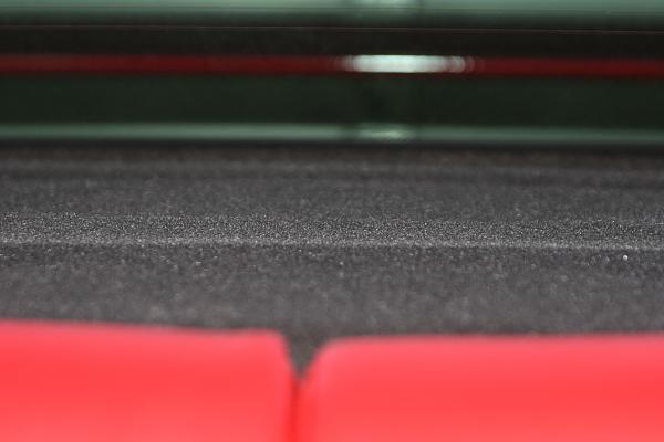

It's there. Really.
Hid mine underneath the rear package tray in the exact center and as far back at the base of the window as possible (almost under the Carlite decal). The ribbed indent running front to back in the center of package tray shelf is about 2-1/2" wide and 1/2" deep: just large enough to accomodate a Terk SIR3 Mini Sirius antenna. The install is totally stealth. I like it. Reception is great.
The last two pics are from GeoStang (at AFM) who helped with my install and were taken during his install-in-progress.
Attached Thumbnails Satellite Radio Antenna Mounting Location Options-img_5749.jpg   Satellite Radio Antenna Mounting Location Options-img_5753.jpg   Satellite Radio Antenna Mounting Location Options-p7240032.jpg   Satellite Radio Antenna Mounting Location Options-p7240033.jpg

Hidden Antennas
Well, thanks for GTEUPP, I moved my XM antenna from on top of the package tray to under it. Just like his pictures, there is plenty of room for both my XM antenna and the nav antenna. A fantastic side benefit was my XM reception increased dramatically (I didn't think it was bad before). I now have no dropouts in the usual locations. Also, the stealth look is very cool. I would recommend this to anyone. It's very easy. Here's how:
Pull the bottom cushion of the rear seat out by releasing the two clips under the front lip
Remove the 3 push pins that hold each side of the rear trim (6 total). The trim piece then pulls out.
Remove 4 more push pins (I broke these, be careful. Easy replacement at the dealer.)
Slide the package tray cover out.
Set the antennas on the tray. They are held in place by the magnets.
Reverse order and all pops back into place.
Thank you for posting the pics GTEUPP.
Mike E
hey man when you wire it into those lights, which is quite honestly the nicest install i've seen, do you have to turn it off manually everytime or will it shut down with the car..i'd assume it would stay on because you can always turn the overhead lights on
