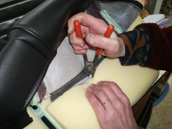

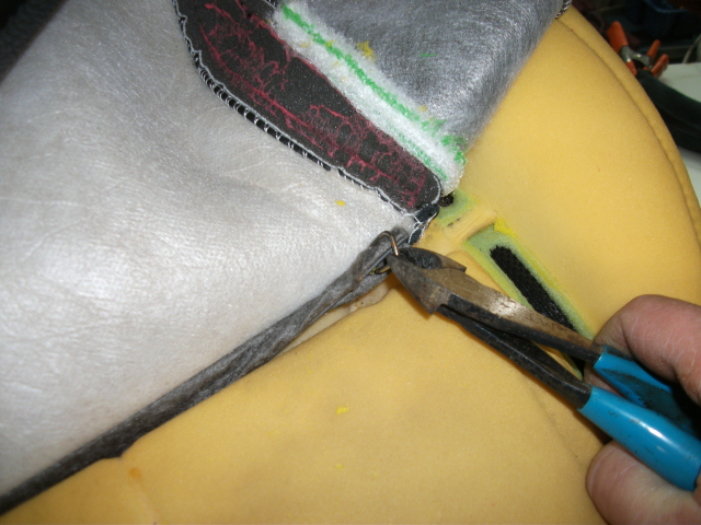

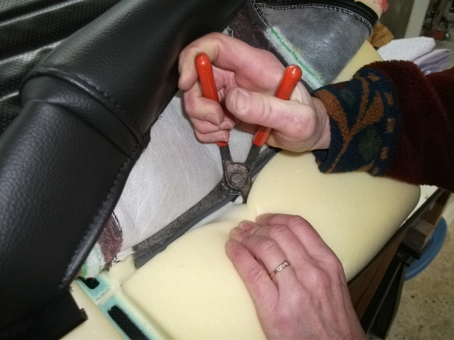

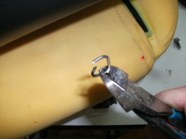

dealing with the hog rings is easy and the best thing to use for the hold downs in the seats. once you locate them, just grab the ring with some side cutters and give it a twist, they open right up and unhook in one step. putting the new ones on is just as easy, just load the ring pliars and clip it around the bar securing the hold down material strip.
i replaced my bottom seat foam with the assistance of my g/f, as it was breaking down at 100k so i took some pics
