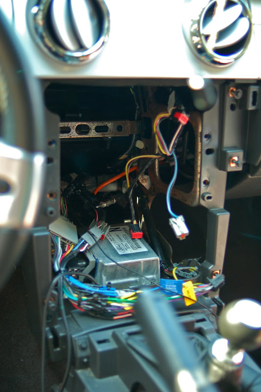

1. Solder up the Pioneer wire harness to the Metra adapter harness. All the color codes matched, and the metra harness even had labels PRINTED right on the insulation! This is the first part where I had to go outside of the directions. I read here on these forums that the amp turn-on signal from the deck was going to be 12V, whereas the amps themselves take 5V. The result is a popping sound when you turn the radio on. So I went to radioshack got a 5V voltage regulator, was just over $1. I soldered the input to the output of the pioneer (blue wire on the Pioneer harness), the output to the blue wire on the Metra harness, and the ground lead to the ground wires in the harness. Problem solved. I tested it using my laptops power supply, and sure enough 19.8V reduced to 4.9V
2. Mount the stereo in the dashboard adapter.
3. Remove center console finish panel, side trim pieces, and the center instrument panel. When you remove the last panel, make sure you disconnect the blower fan and HVAC control harnesses first (you can access from the sides), otherwise it'll be a B*TCH to remove
4. remove the Skipper 500, plug in the adapter harness.

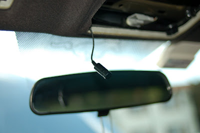

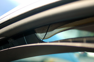

I used a zip tie to hold the cord at a right angle at the very left of the dash and then snaked it up through the A-pillar. Now for the reason for removing the sunvisor, overhead console, and associated parts. I routed the microphone over the headliner from the A-pillar to the overhead console:

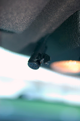

6. Next it was a simple matter of reinstalling the overhead console. The microphone has a tendancy to just hang from the seam which looks...pretty stupid. So my answer is pretty simple and decidedly low-tech. I wrapped a black twist-tie around the microphone and then flattened the ends out like so. After putting the welt back in, I just pushed the twist tie in the seam and now it blends in pretty well!
7. Next, take up the slack on the mic line and tighten down the zip ties, and put all the trim panels back in, with the exception of the stuff related to the center console.

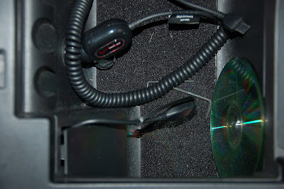

8. Route the USB cable through the center console and through the access plate in the console compartment under the armrest. I zip tied the cable to the wires that go to the e-brake so they wouldn't interfere with the e-brake lever. This is what the USB cable looks like right now. I'm pretty sure I'm going to have to drill a hole through the access plate to get it to close flush again.

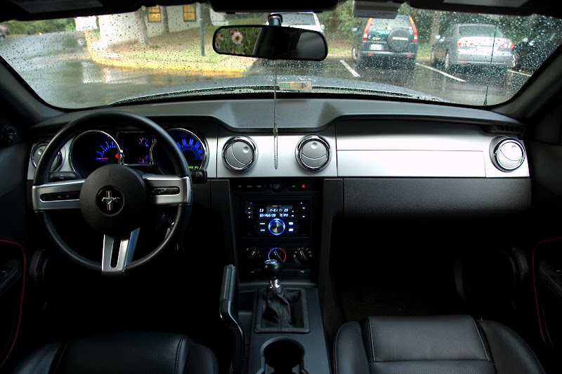

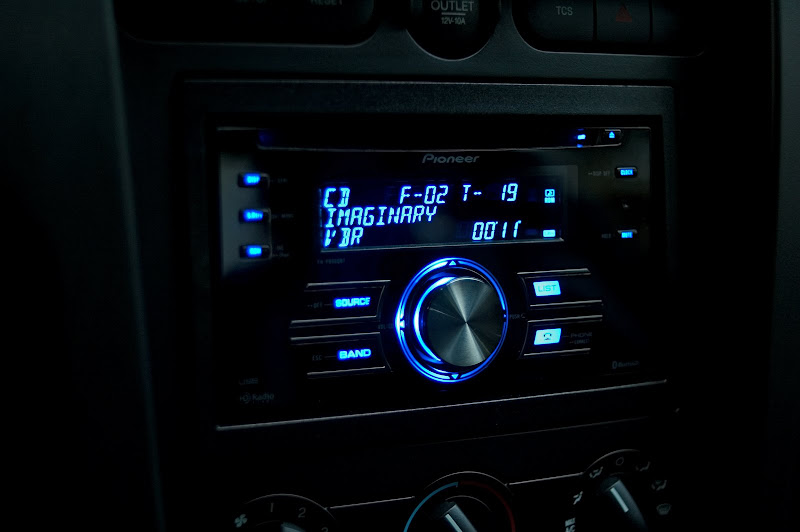

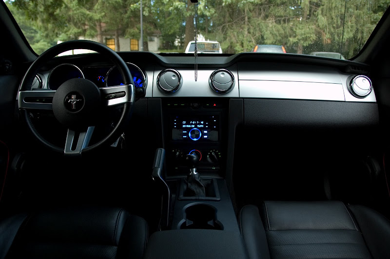

8. From there on out, its just a matter of attaching the wiring harness, USB cable, and MIC cable to the back of the stereo, bundling the extra wire from the mic, bolting the deck in, and putting everything back together and enjoying the music. And now the results! (1st pic over exposed so you can see the details better)

It does sound amazing though. I turned the Skipper 500 right before I started the installation process for a point of reference. After the installation I expected to hear crappy quality until I got the EQ's set up but my jaw dropped when it first turned on. Even more, it was the RADIO. The **** thing sounds better on FM than the Shaker did on CD! I'm extremely satisfied with it.
