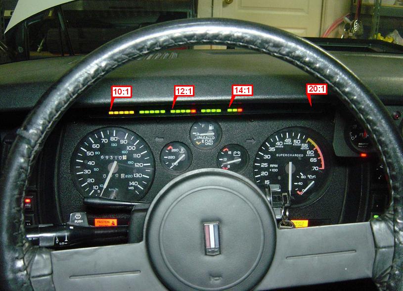

The reason why I don't want to use the "Rallye Pack" design is because I plan on constructing another DIY wideband O2 circuit with custom display, exactly like I have in my TT IROC-Z. This custom display includes a bargraph with 30 rectangular LEDs (see pic of it in my Camaro). I'd like to place it in a similar location in my GT but I wouldn't be able to see it because of the steering wheel. So, I've decided to place it just above the steering column. This mod will be just one more in my list of unique mods that I have yet to start -- still kind of new to this '05 scene....
