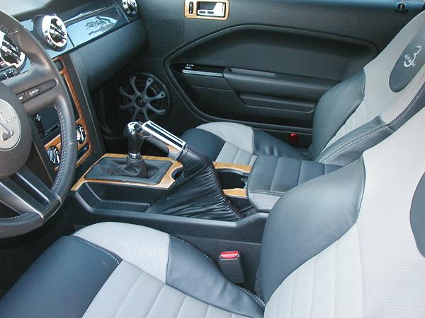

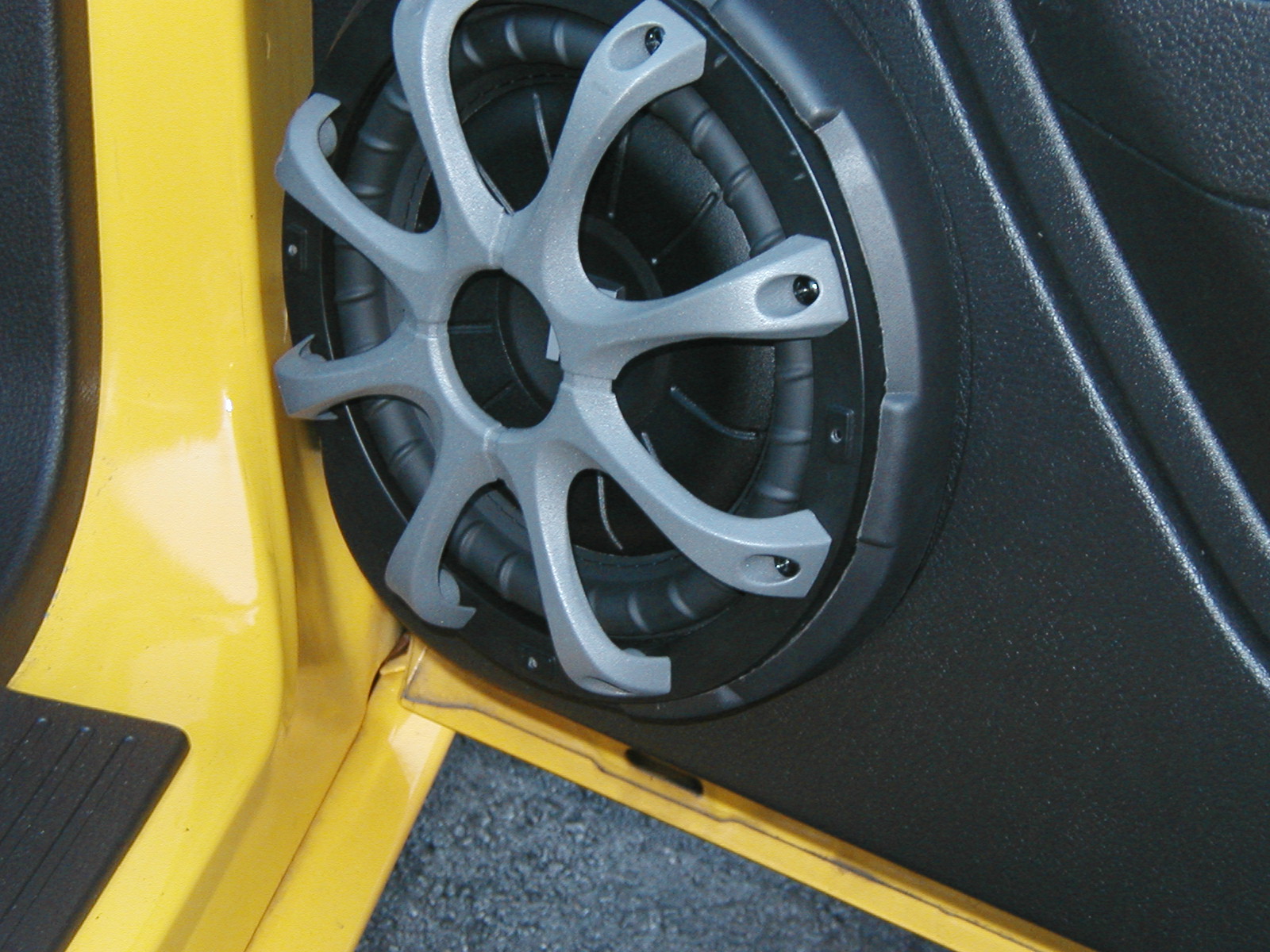

Yes they do fit ... You're right about the adapter ring , it moves the shelby's out about 1/2" further than the OEM ones were and that's why they fit without any modification. I also trimmed the OEM ring so it would cover the lower part ...

That makes more sense, and cool usage of the stock surround. Mine already stick out quite a ways, constantly bumping my foot on them -- how thick is that adapter ring?
I probably shoulda made my own when I first installed them, too lazy. They work fine the way they are now, and not too obvious they don't fit perfectly.

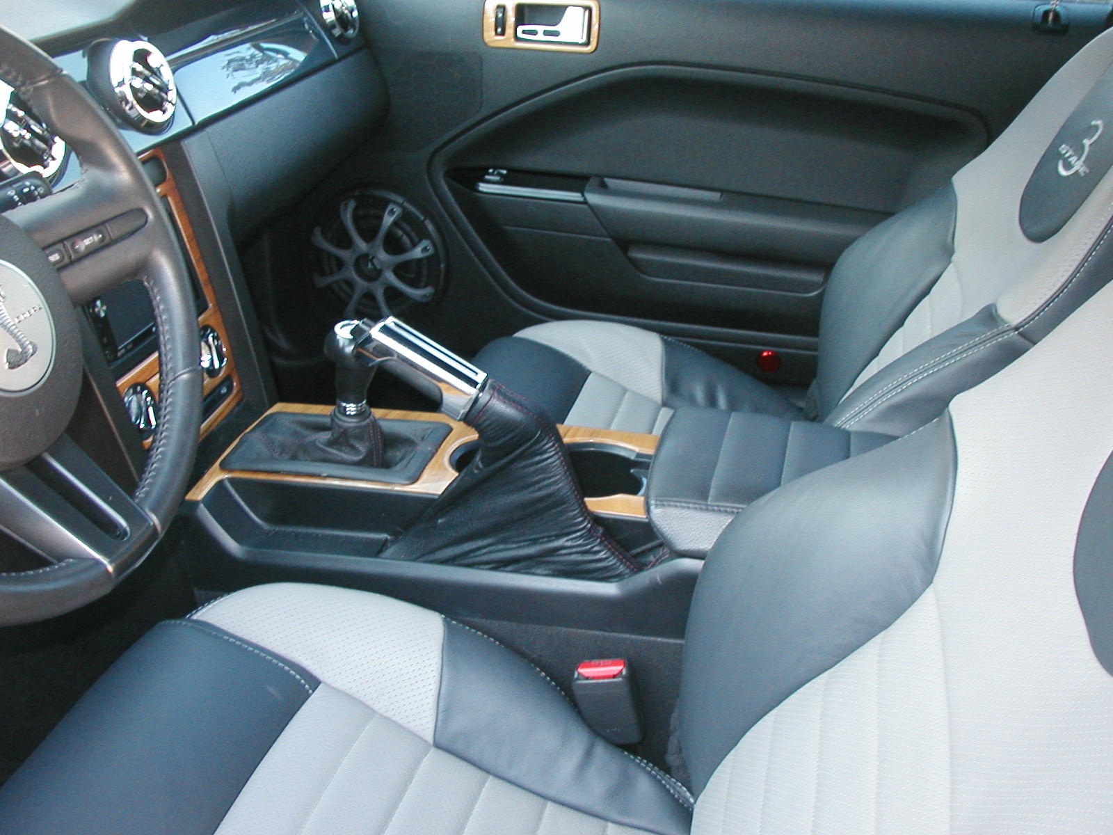

Josh , I didn't measure the adapter ring , but I think it's 3/8" or 1/2" thick. Even with the Shelby grille it stuck out further than the OEM grille and with the new Kicker grille it's even a little further out.
Initially I had thought about getting the Kicker grilles powered coated black to match my SHR window switch plates and door lock pockets. But once I got the grilles and installed them , I liked the way the silver compliments the grey on my seats and decided to leave them as is ...

Gotta say I agree now that I see the entire thing, that is one beautiful interior! Be nice if Kicker made them in grey and in black.
