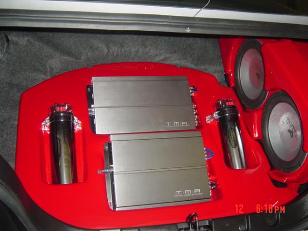

Pioneer Shallow Mount Sub
I have listed a link for you below to buy the Pioneer Shallow mount sub. There are other places you can get it cheaper but you can see what it looks like at the site I posted. They can handle a max of 500w with a continous 120w. They only need 2.5 inches depth for mounting and use a new air suspension system that requires no spring. It is the spring that needs the deep cone and uses up most of the depth. They are a great upgrade over the stock door subs. I am using TMA amps to drive my upgraded speakers. I put in Rockford Fozgates 6X8s in the doors and rear deck and TMA subs in the Shaker box in addition to the Pioneer slim 8s in the door. I dub it the Shaker 2000 system.

Thanks for the info. I see a pic but no link. Am I missing something? BTW, where is the factory amp for the door subs anyway? Can I just use that wiring for power, remote turn on, etc?? My knowledge of electrical stuff is limited so thanks in advance for your patience.

The door sub amps are behind the drivers side interior kick panel. The shaker 1000 amps are behind the subwoofer enclousure. The factory amps do have power and remote wires but they are hard to access because they are behind the amp in cramped spaces and they are harness wired and do not use the traditional colors that people are used to like the head unit. Go to Pioneer dot com and search for their automotive shallow mount subs.
