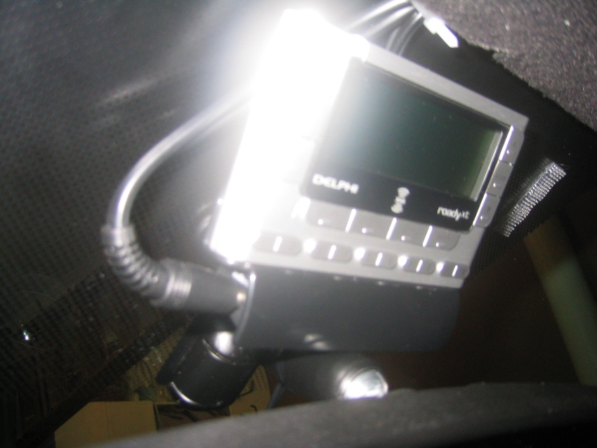

I hate seeing wires so everything was hidden in my install. I mounted my rodey above the rear view mirror (On the pony black-out on the glass) -see pic. this location works well for me b/c it's out of the way, you can 't see it from the outside + it's easy to change the station w/o really taking you eyes off the road. Wires run accross roof down side piller behind glove box to radio.
PIE behind radio and power spliced into the 12V dash (behind). My rodey actually broke 2 weeks in and delphi is sending me a new one now - I have RCA to a Y connector and just swap out my Nano and Rodey as needed. I clip the nano to the XM holder base and it works great.
