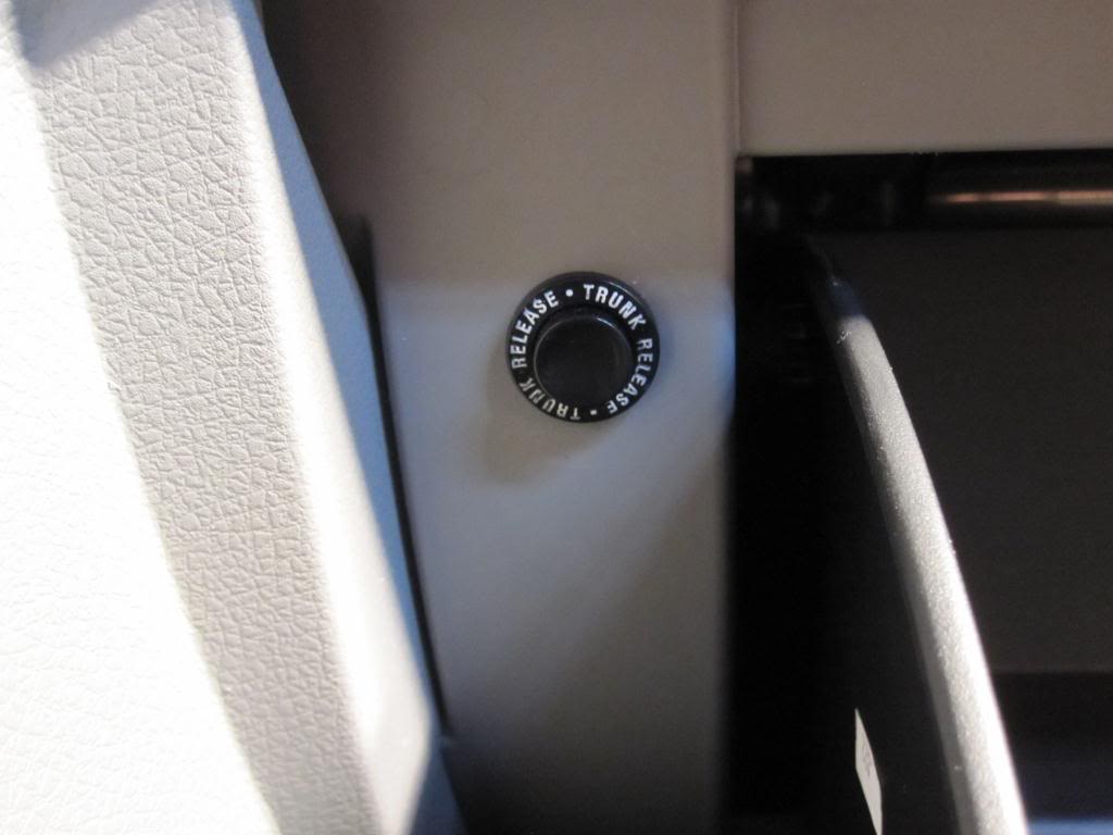

Not the console, but in my 08 I added an OEM Ford button (part number D3AY-19C542-A) in the glove box. Pretty easy to do - just a ground wire and then tap into the (as I recall white wire with pink stripe) in the kick panel / scuff plate wire bundle:

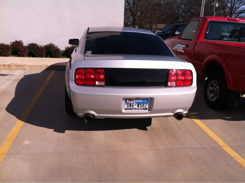

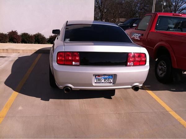

Well here's the new trunk
Attached Thumbnails anyone added their own center console trunk switch??-image-1377582485.jpg

Old Feb 8, 2013 | 02:50 PM
shurtual86's Avatar
Joined: December 16, 2011
Posts: 4,567
From: Minnesota
I like, a lot cleaner look.

The SH kit works well but any other normally open switch would work too and a non labelled one would be less obvious. One side of the switch splices to the wire in the wire bundle (colors noted above) and the other side of the switch goes to ground - anywhere. I like having a button (I put mine in the glove box as in the above pic) incase I don't have a remote handy. Also - it's hidden in the Glove Box and I don't have to leave a remote in the car.
