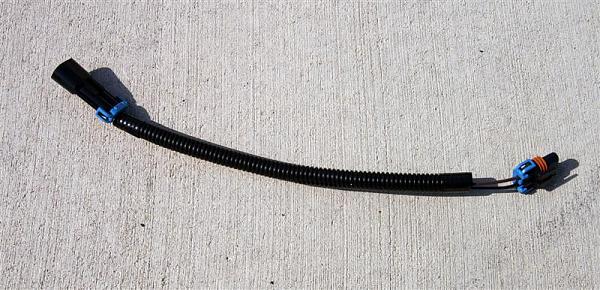

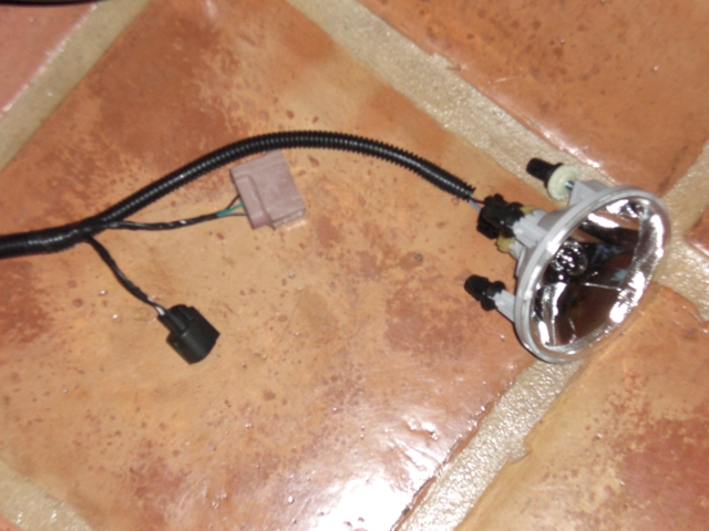

Post Parts needed for slice & dice wiring
I saw these on another thread. I don't imagine I need this for my Shelby GT500 headlights or fogs considering I got the whole wiring hardness from
KC. Maybe this could help you - saw this on another thread. Don't know
if the KSR units could help as well.
Male connector: (plugs into the stock wiring harness) Delphi # 12084167
Female connector: (plugs into the fog light bulb) Delphi # 12059183
Male Connector: 12084167
Female Connector: 12059183
Terminals: 12077411
Locks: 12059185
Seals: 12015323
http://www.azconn.com/feature.htm

Old Oct 3, 2006 | 08:54 PM
StangNut's Avatar
Joined: August 23, 2004
Posts: 5,448
Likes: 13
LOL.
Thanks man, but that was my thread. Unfortunately no one sells those exact connectors except in large quantites. (I only need 2 to 4) You're right, the KSR (or SSE) harness extension would work perfect... if they would sell me one.
That last picture (the small connector) is what you will be cutting off of your stock fog light harness (it plugs into the stock fog light)to splice in the Shelby harness, I think. That's the one I need. I was hoping there would be someone who hadn't thrown the connectors away after their conversion.
Of course I could be completely confused about how the harness gets installed. Someone please correct me if I'm wrong so I don't get my hopes up.

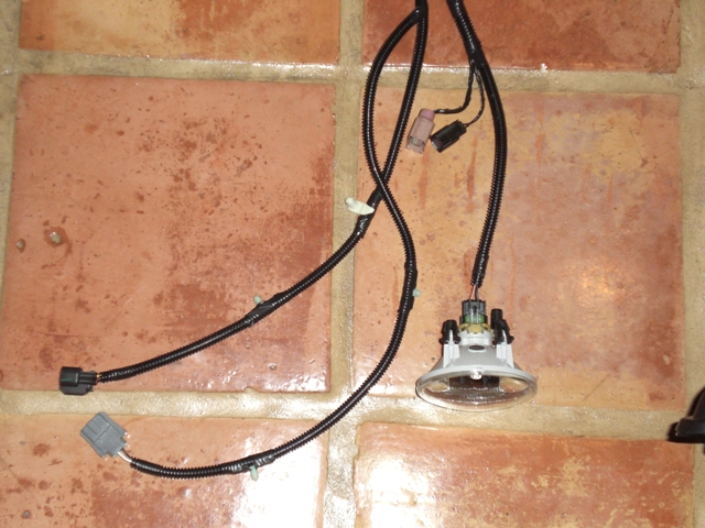

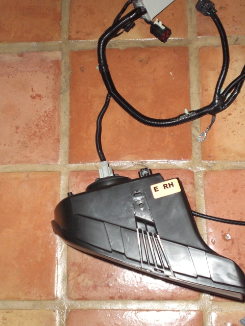

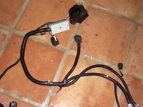

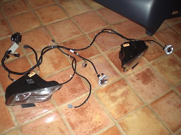

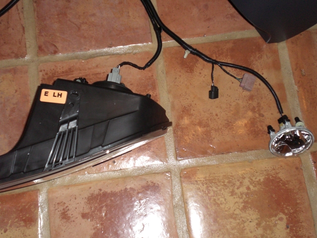

Question Wheel of Fortune - Identify the plugs
Figured I make this a game and I've already provided some of the answers.
This is the Shelby GT500 wiring harness laid out as if you were right in front
of your mustang. So guys / gals feel free to fill in the blanks here.
The pictures are numbered 1-6:
Name where each plug from left to right connects to in each picture.
Good Luck.
