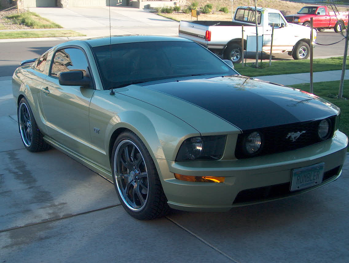

My 06'GT with 20's,no stops on this ride.It also had a FRPP Handling Pack on it as well.
