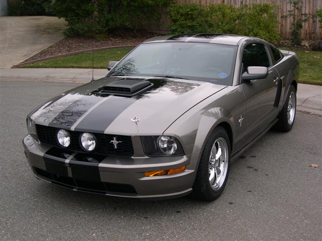

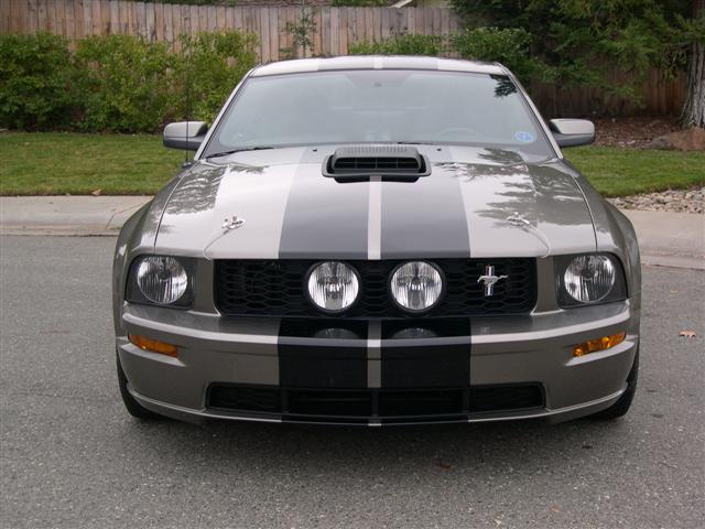

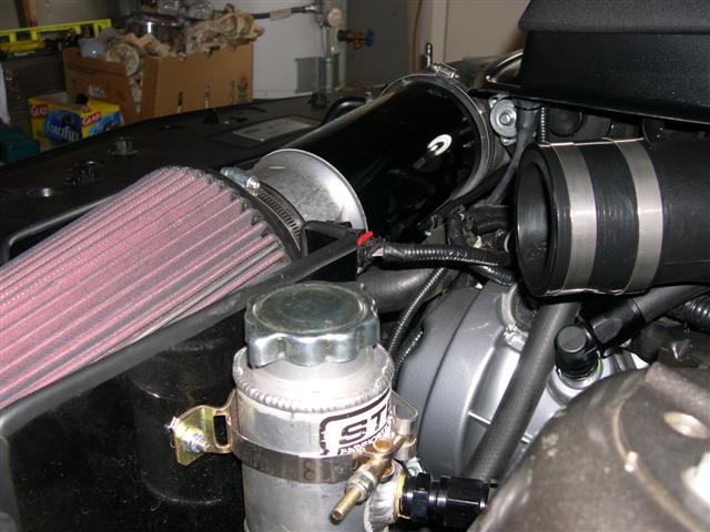

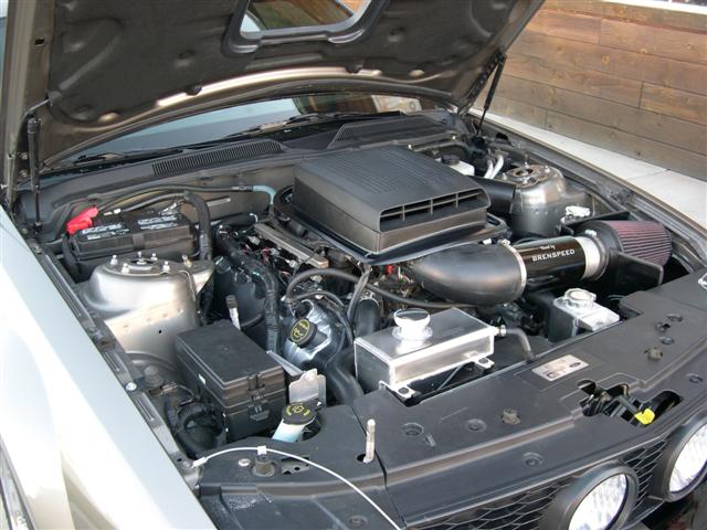

I guess I didn't post pictures of the end result so here they are. I used a cutting wheel to trim the shaker after I masked it off and used a sharpie to mark where I wanted to cut. I then took a propane torch and melted away the plastic fuzzies from the cutting wheel. Lastly I buffed the edges with a polishing wheel and it came out so nice I didn't even bother to add the trim around the edges.
