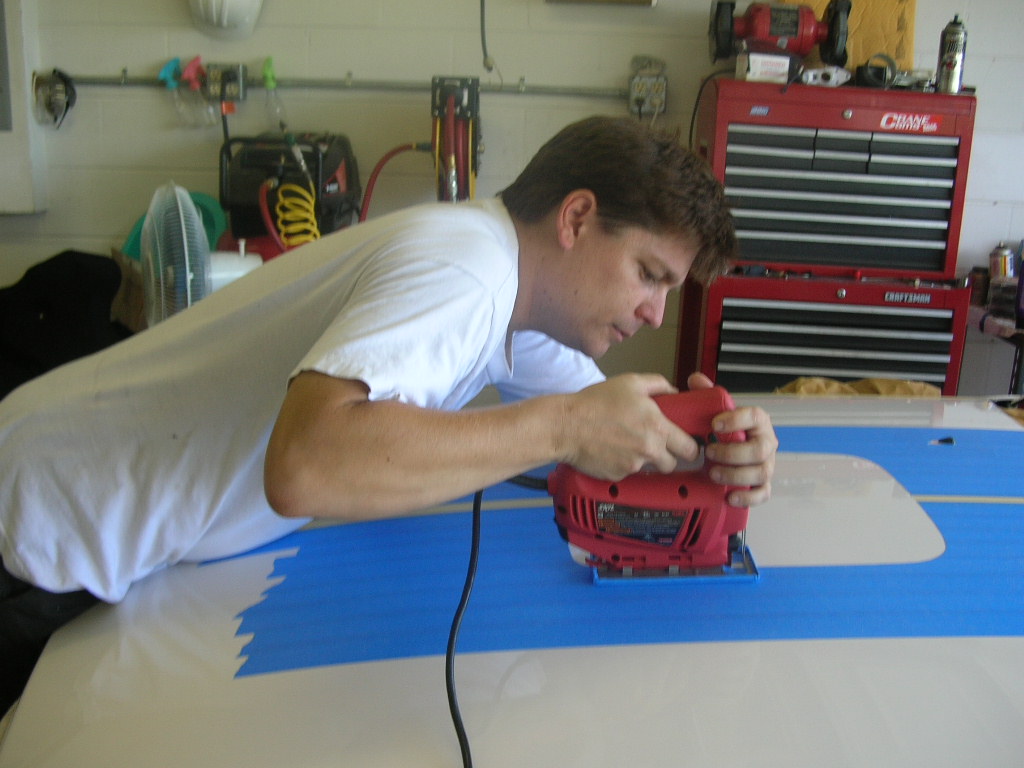

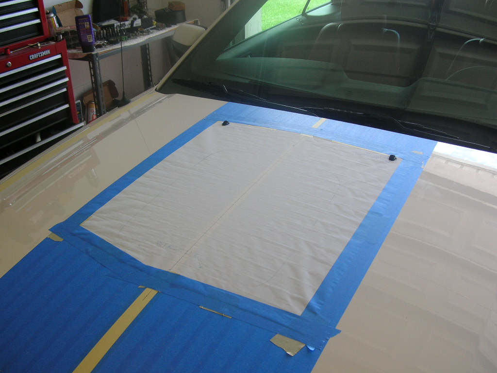

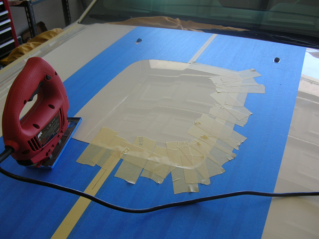

We all thought that at first, at least for a little bit. It's just so so so so so so so so easy. With the correct blade, the hood cuts like butter. Plus, with the trim ring, you could mess up pretty majorly and it would still be covered up.
Attachment 37399 Attachment 37400 Attachment 37401 Attachment 37402 Attachment 37403
The hardest part was NOT cutting the hood - it was making sure the shaker scoop was perfectly centered in the opening (something somebody at the production facility wouldn't care as much about).

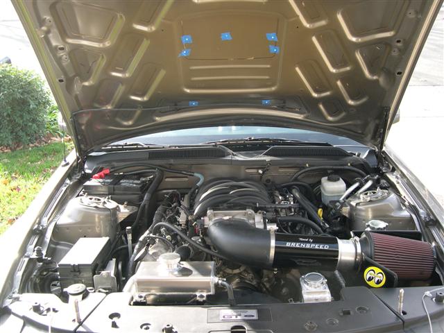

Took off the scoop, strut tower brace and engine cover today getting ready for the shaker to arrive. Very nasty under where the scoop was attached.

So I take it your biting the bullet and getting the holes filled and hood repainted? If so may I suggest getting rid of your washer nozzles and replacing with these.

Hey....just a heads up ....you may already know but the cut out underneath the hood.....or the square you see...it is exactly where your shaker will go for the most part....so it appears that the back holes of your scoop will have to be filled.....

The back 2 holes from the shaker will have to be filled from the Roush. So to answer your question the opening for the shaker is larger (thank God) than the holes for the Roush scoop.

the shaker I think will not cover your back two holes....if that is them where the blue tape is? because I think the shaker will only go where your square is under the hood?

The back 2 holes from the Roush will have to be filled for the shaker.

Jigsaw with a metal cutting blade. Small teeth!
