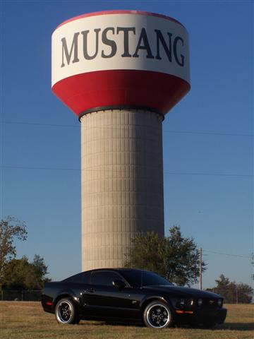

For those of you thinking about this retrofit, don't be apprehensive. Now that everyone knows what parts are needed it should be a breeze for your dealer. My guys had no problems making this work. The results are friggin awsome in my opinion. This turned out better than I ever imagined and on my drive home I swear three or four people about drove off the road trying to check out the car. Even though it was a little pricier than I first thought, I'd do it all over again.
One more thing. I don't wanna take any business from KC at Clevenger Ford by any means, in fact, i encourage you to get your parts from him if you can, but if any of you are in the central OKlahoma area, or if you are within several hours of Oklahoma City, I can highly recommend Joe Cooper Ford in Yukon for the install and the Mustang Collision center in Mustang, Ok for the finishing touches and the paint job. They did a great job. The car looks like it came from Ford this way.

Looks awesome! Any thoughts on changing out the rear bumper as well?

Not at this time, maybe in the future.......once my bank account recovers

Those people who live in and maintain that cemetary have got to be getting pretty upset by all of us Mustang owners.
Car looks freaking awesome. I however vote that you get either the Shelby rims or the upgraded front rims from the GT. And why not, it's not my money!!!!

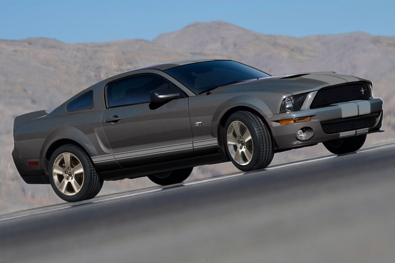

I was at one point going to do the same to the '07 I have ordered. I had estimated about $3500 to do the front end and use the vinyl stripes. I definitely did not anticipate the $460 worth of plastic vents and was as surprised as you when I heard that from Kevin a little while back!
Two questions -
1) did the existing windshield wiper fluid tubes get reused?
2) what tri-bar emblem is that and how did you mount it?
PS - Just for grins, Doug "Burningman" Schramm's Photoshop work for what I had planned is attached.
Attached Thumbnails SHELBY CONVERSION IS COMPLETE - pics/parts list-tungsten_front_resize.jpg

Wow, your car looks
Everything looks perfect on your car. Where did you get those Bullitts? How wide are they?

bullitts are from Mustang tuning. They aren't the deep dish, but are a lot deeper than stock. They are 18" wheels and are 9"wide. Wrapped w/ BF goodrich KDW II's.
