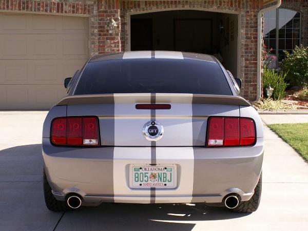

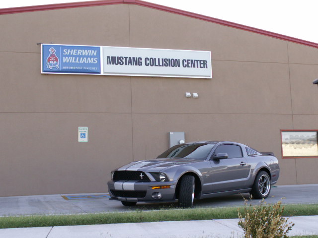

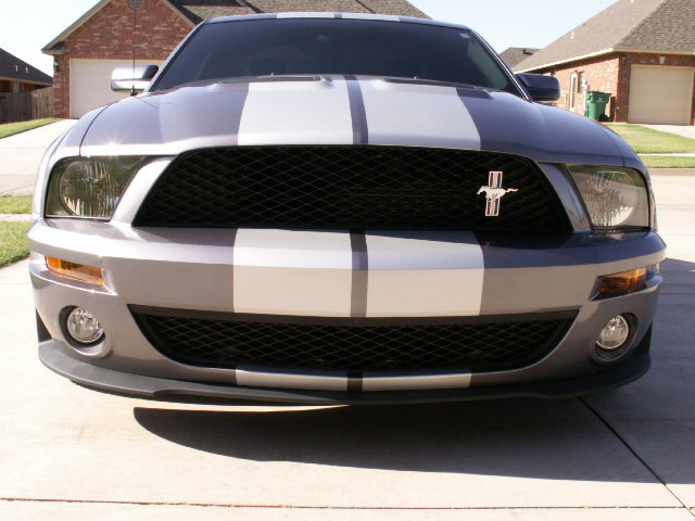

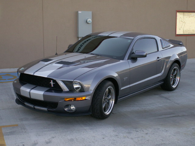

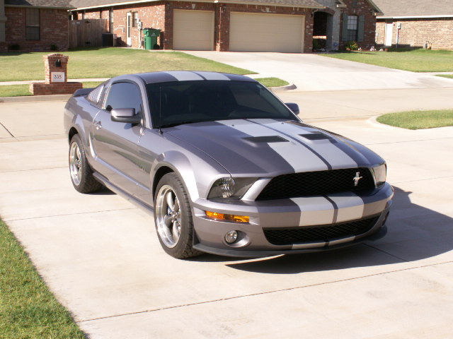

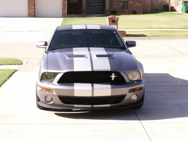

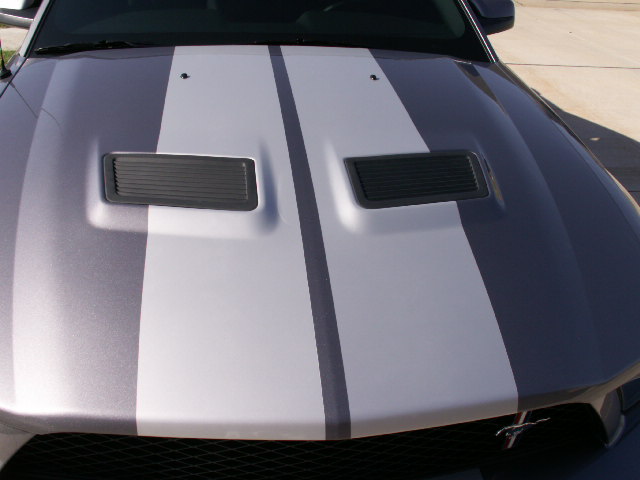

Ok, I just picked the my car up today. Here are the pics. Parts list will follow. The painted stripes are 10.5 inches wide w/ a 1.5 inch gap.
Attached Thumbnails SHELBY CONVERSION IS COMPLETE - pics/parts list-06gtpics-001.jpg   SHELBY CONVERSION IS COMPLETE - pics/parts list-06gtpics-003.jpg   SHELBY CONVERSION IS COMPLETE - pics/parts list-06gtpics-007.jpg   SHELBY CONVERSION IS COMPLETE - pics/parts list-06gtpics-008.jpg   SHELBY CONVERSION IS COMPLETE - pics/parts list-06gtpics-015.jpg

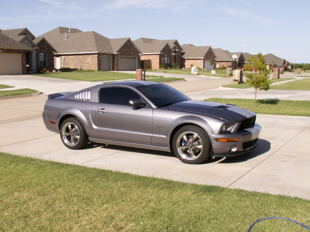

a few more
Attached Thumbnails SHELBY CONVERSION IS COMPLETE - pics/parts list-06gtpics-018.jpg   SHELBY CONVERSION IS COMPLETE - pics/parts list-06gtpics-014.jpg   SHELBY CONVERSION IS COMPLETE - pics/parts list-06gtpics-004.jpg   SHELBY CONVERSION IS COMPLETE - pics/parts list-06gtpics-009.jpg
