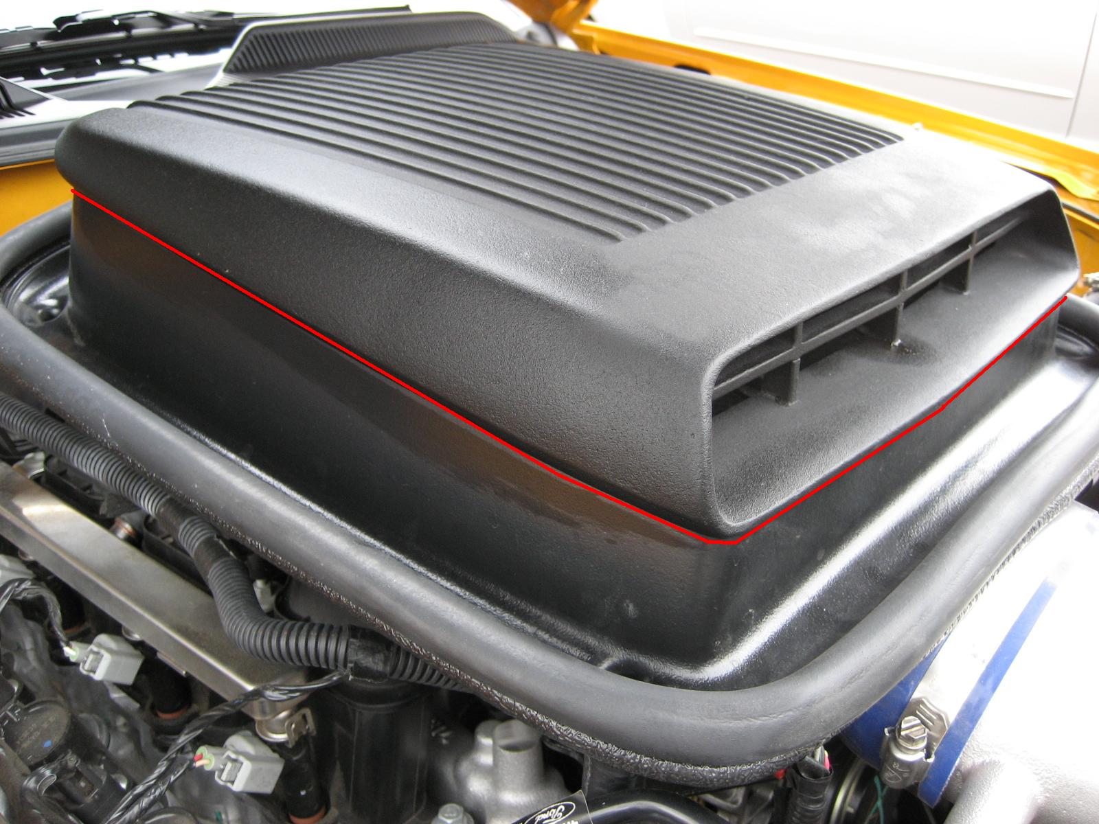

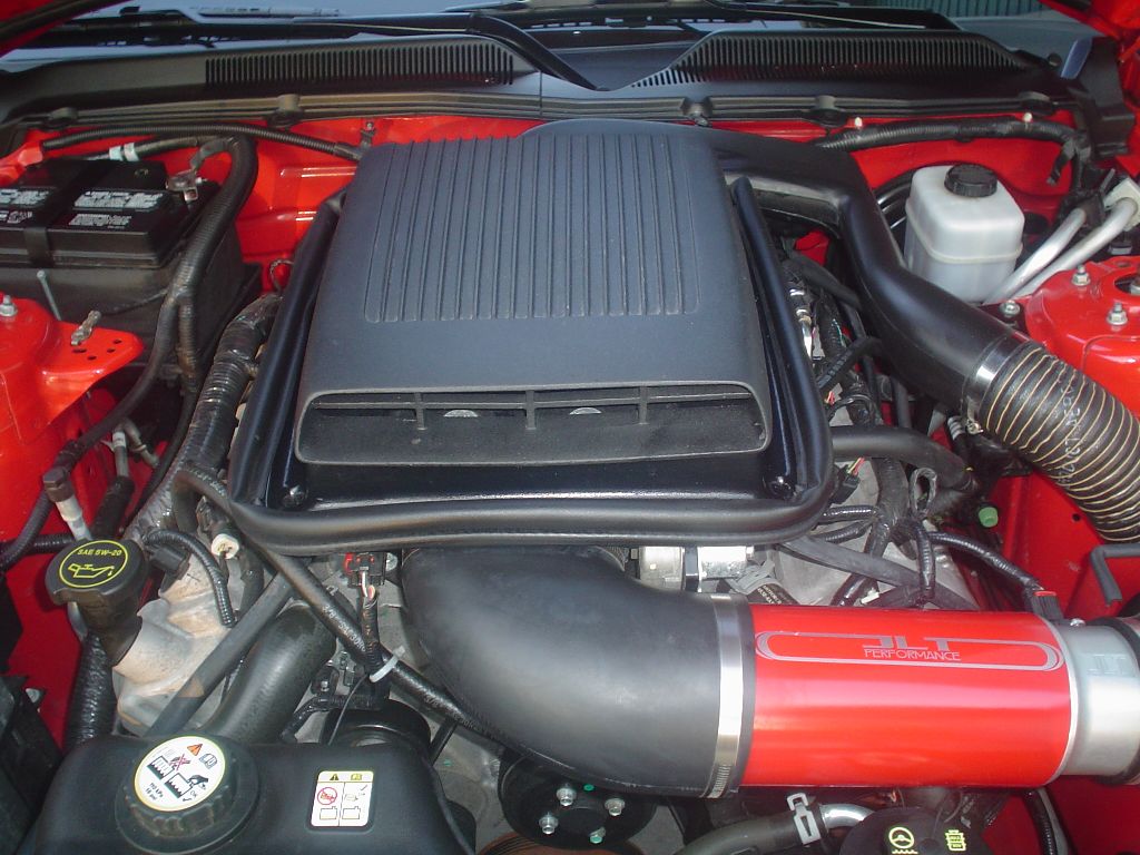

Just trimmed my shroud tonight also.Only thing I didn't like about the new Shakers was all that plastic. I'm old school I guess, besides I'm sure it traps heat under also. I added some door edge weaterstrip around the edges of mine,hopefully it will help in keeping water & rain going where it should.I used my Dremel & a cut-off wheel, trimmed the shroud about a 1/2" from the edge of the water 'channel'.I left the drain area intact under the air intake tube,you can't see it much under the tube anyway.

That looks great, Larry. It looks a lot more like an old school Shaker now, and also very similar to the Shaker setup on a Saleen PJ.
