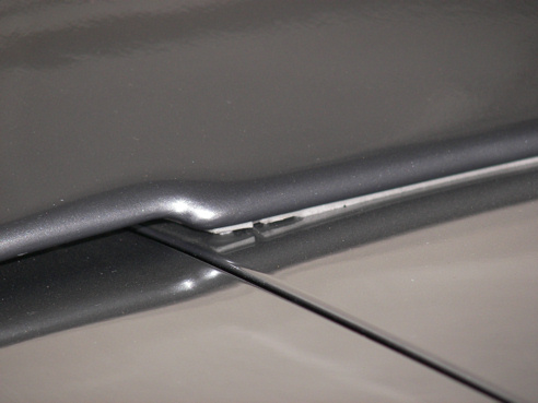

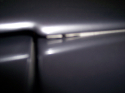

Here are some pic's. I'm not a photographer...but I think you can get the idea. The spoiler looks great...but if you look closely...you'll see the tape separating from the trunk lid on the ends.

Just curious, what did you clean the tape area with before you installed the spoiler? I washed the entire area with mild dish detergent and then wiped it down again with alcohol 2 times before installing. Its been on for around 3 weeks now with no issues so far.

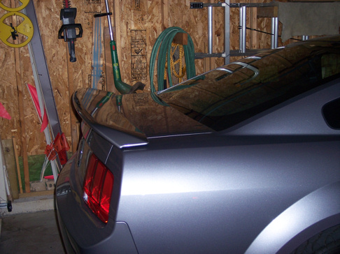

Sorry for crap quality but here are the pics... you can see a little tape gap on corners, but still overall quality does not suffer...

I basically did the same. Washed with soap and water...than cleaned it with alcohol. It stuck pretty good until I took it out on a hot and sunny day. The adhesive on the tape was really soft and no longer stuck. With the car in the cool garage...it will stick again for a little while. The problem is that the tape is not strong enough to hold down the corners on its own. The shape of the spoiler does not exactly conform to the trunk lid. The tape will always have to fight against the upward pull of the spoiler. That's why the manufaturer decided to add the two outside attachment points. I heard from someone that the earlier models did not have those additional attachment points. If I had drilled those holes and added those extra screws...I would not be having this issue. BUT...I don't want to drill any holes in my trunk lid...so I decided to look at the OEM model instead to see if it has the same issue. I'm still lokking into it.
