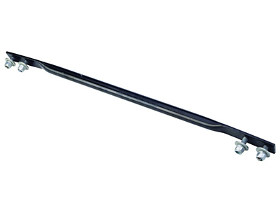

Just thought id share this... American muscle sells this brace for 60 bucks i believe.. I thought id make my own..
AM:

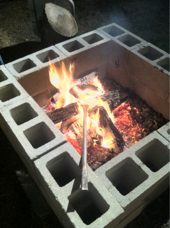

I dont have fancy machinery so just did it old school.. Got a piece of stainless steel tube, cut it to length.. Then build me up a nice fire and heated the ends and hammered them flat.:

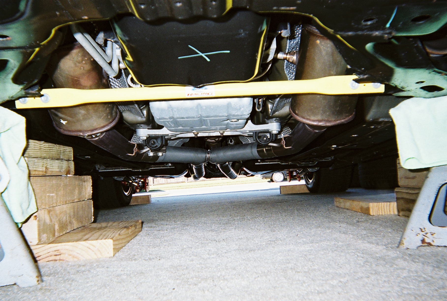

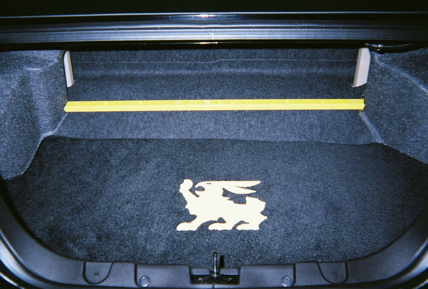

,,, That front brace came stock on my 2007 GT/CS , the car came with one from Ford , and here is my Shelby Autos rear brace ,, very nice job you did ,, kinda cool to see someone really make one . ,,
