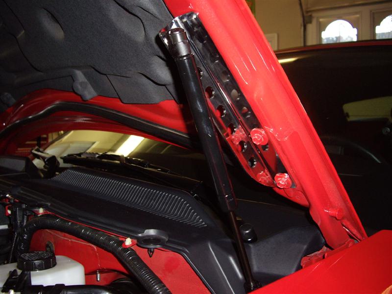

Thumbs up Love my CDC Hood lift struts
I love my CDC struts. They installed easy and was very good quality. NO they are not powder coated brackets....I did not see spending 20 bucks more for that.....plus if you take a few minutes and some brasso, you can make them shine.
Attachment 17460
Attachment 17461

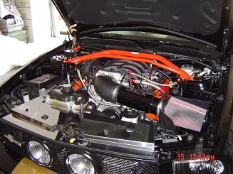

I also got around to installing the polished radiator covers.
Attachment 17462

very nice, was it necessary to drill holse in any part of the car to put them on?
they look great!

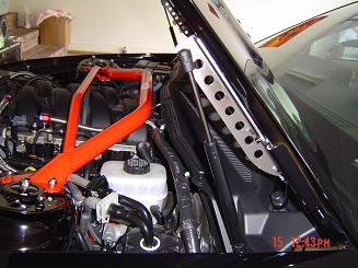

+1 for the CDC struts. A little Mothers metal polish and my dremmel and they shine like chrome.
Attached Thumbnails Love my CDC Hood lift struts-hood-struts-001-medium-.jpg

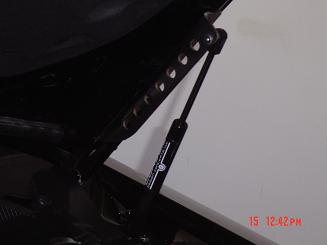

If you decide you want it to blend in better you can always remove the decals on the struts and paint the brackets like I did.

+1 on removing the decals. Looks much more factory this way

traffic142, Are your Gas Charge Struts on up side down?
Any I've seen have the Thick Barrel attached to the Hood Bracket.
May not make any difference.

Nope, bolts on to existing spots.
And good eye, I never caught that. I wonder if I do it this way it will not rub the decal off???
How hard is it to snap them off and back on??? Will I mess them up??

Just get a flat head screwdriver and wedge in the little metal clip. Do the same to the metal clip on the bottom end. Don't worry you won't break it. Just make sure you have the prop rod or a friend holding the hood before you do this.

Does it really matter???? To me it looks better like I got it. I will probably swap it out, but to me mine looks better.

Not sure if it matters but the instructions say to put them in the way I have them. Give CDC a call if you really want to know.

I'm not sure but if they are upside down you could get water or something running down into them. Probably best to change them.

Thick part is always up, lubes the oil seal that way.
