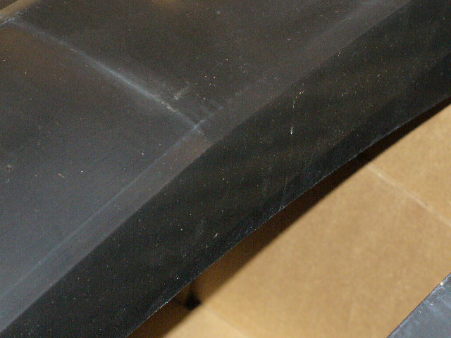

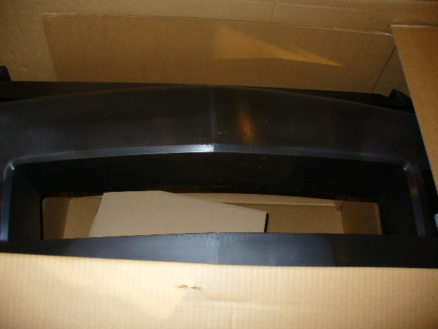

Okay, well how about one for the roush front fascia. Have you made one for that? I am looking for a bracket, so I wont have to drill my new fascia when its painted. Thanks for any info
If you could post some pictures of the underneath of the roush bumper it might be possible the CS bracket would fit (it's more versatile then the GT one). But if not it would be next to impossible to make one unless I had a "test car"

Ben, I have a Roush on order and live in Texas so I need a front plate. If/when you get something to work I will buy one.

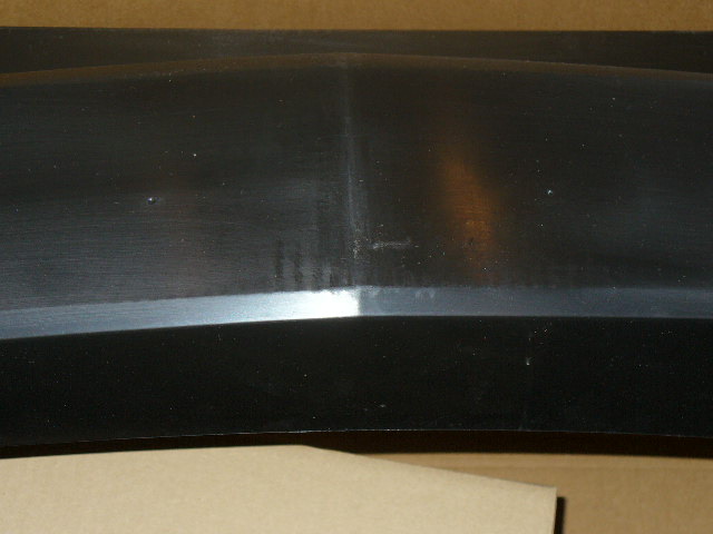

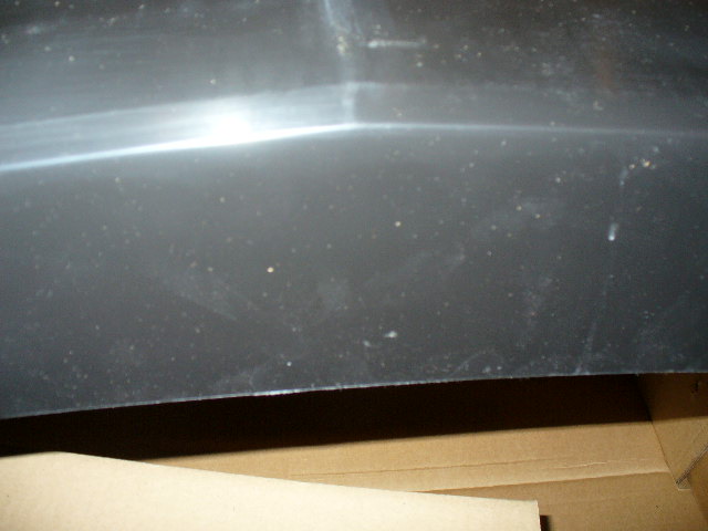

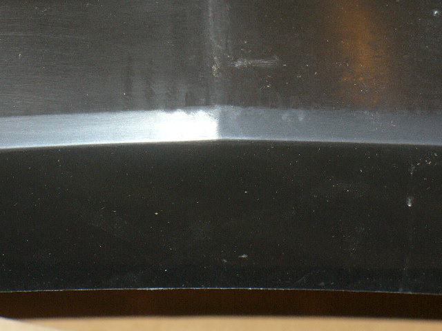

Here are some pics of the roush front fascia. It appears that the styling around that area is pretty much stock, but goes deeper underneath. From the bottom back edge of the plastic to the angled center tip is approx. 4 1/4" in length. But it is flat and pretty much like a stock gt piece the indented edge is just a hair different. So It looks like the bottom piece for the bracket would need to add however much the difference from the stock bottom back to 4/1/4" is. so in other words just measure the gt piece and add the difference to your already made gt bracket. I guess I will be a guinea pig if you dont mind making me one. Let me know if you need any other info. etc.

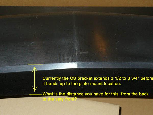

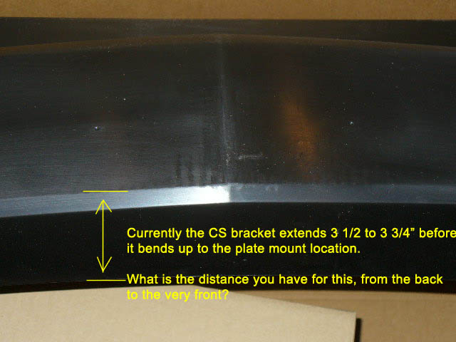

Wow that was quick, based on the pictures I would say my CS design will work perfect with this bumper, but I think it'll have to be a little longer to extend out to the bumper front.
I attached a picture, currently the CS bracket extends about 3 3/4" before making the bend. You said the Roush bumper cover is 4 1/4". What is the most important is the measurement as I've depicted on the attached picture.
Also would you say the angle between the bottom and front to be 90 degrees? As the CS would is around 75 degrees or so (I can't remember exactly what I measured)

well remeasured. I put a cd on top of the center crest and measured from the very back to the cd which is laying on top in the center. the measurement after remeasuring is pretty much exactly 4 1/8" but you need the gap for the plate/screws. So whatever that gap is add that to the 4 1/8". yes its like 75 degrees if that is the correct degree. It is not 90degrees/small slant coming up from back to front. Let me know if you need something else. Thanks

I've been on vacation the last week. I can fab up a "CS one" that is a bit longer to match what you have measured.
