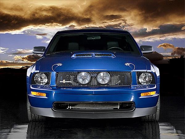

Well here's where I put mine. I went more for the old school hood pin look then the newer thicker hood pins Shelby is offering now.
