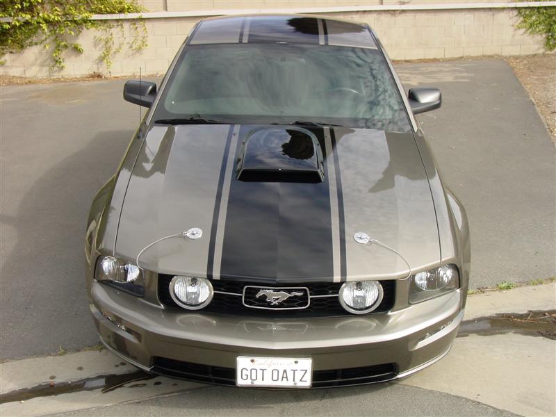

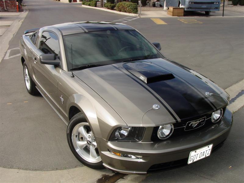

Been there, done that......Mine was going to be hood only too....Didn't end up that way however.....
Read Rob's instructions through a few times. Make sure you have plenty of wetting solution mixed up, and in the squirt bottle. Keep the stripe good and wet while positioning.....
Make sure you have someone to help you peel the vinyl off the backing. It is a huge one piece decal. You need to make sure the stripe does not fold back against itself.....
Understand that with the hood, you are fighting several compound angles at once. At some points, you will think there is no way the vinyl is going to cover, and come out wrinkle free....Eventually it does....
Use your hands as much as possible to smooth the stripe, as opposed to the squeegee....Make sure the roller on the squeegee is clean of any debris.....
Take your time, and have your patience ready!! The pinstripes are an absolute cakewalk.....
