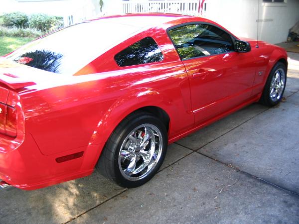

I run the 18x9 AR Redlines w/255-45's on all four corners.Its very sticky and handles well. I'm pretty sure the Redline and Razors are the same offset @ 40MM. 555 Nittos may come in a 265-45-18 but you would have to check their spec sheet for tires sizes to be sure.That tire tire is a little bit larger in diameter and will set your speedo up a few more MPH but not enough to worry about.
Here is a pic of my tire set-up,it does look pretty wide out back for 9"wide wheels.
Attached Thumbnails Help with tire choice/sizing-hpim0288.jpg

Thanks Poco, it looks SWEET! I definately feel like I made the right choice now,

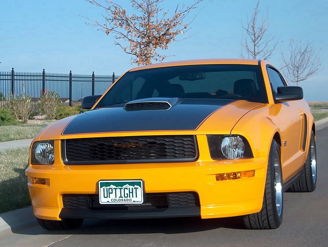

Running a 305/35/18 on 10's on mine in a Nitto 555DR 275/45/18 on 9's on front.
these are old shots before i lowered it with a BMR kit. very nice fit with no rub at all. Speedo was almost dead on. And if you have a programmer you can dial the speedo in perfectly.

THESE ARE 20'S BUT 295 30 20 OUT BACK ON A 10.

Nice looking Yellow man...tough front stance...
