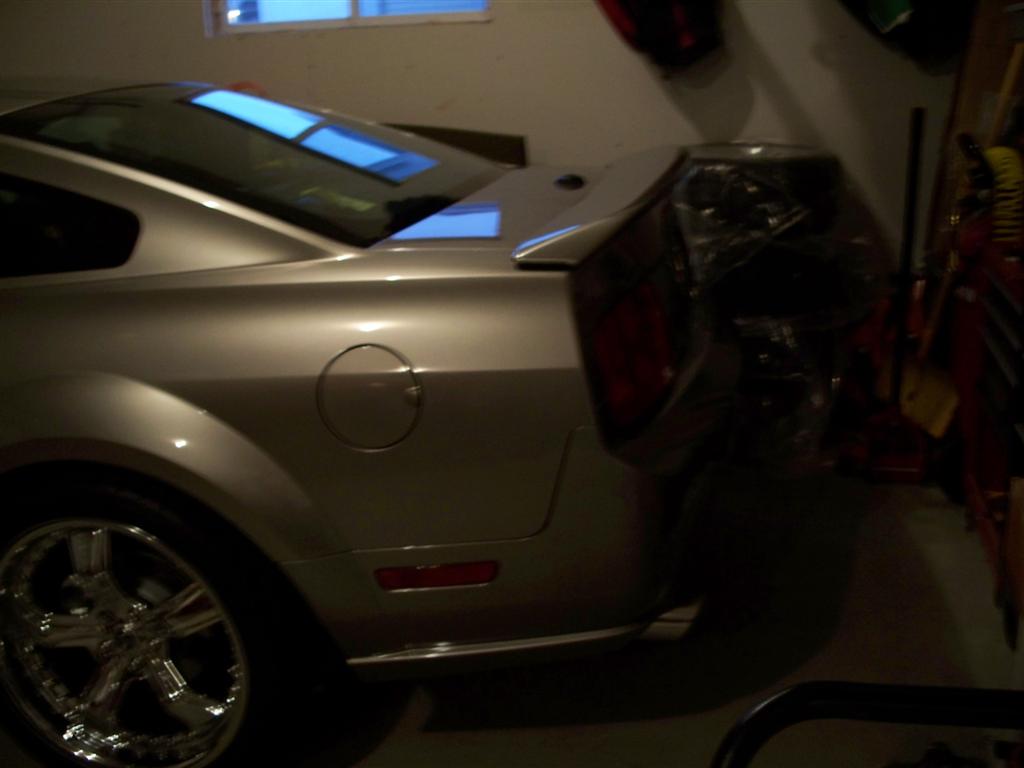

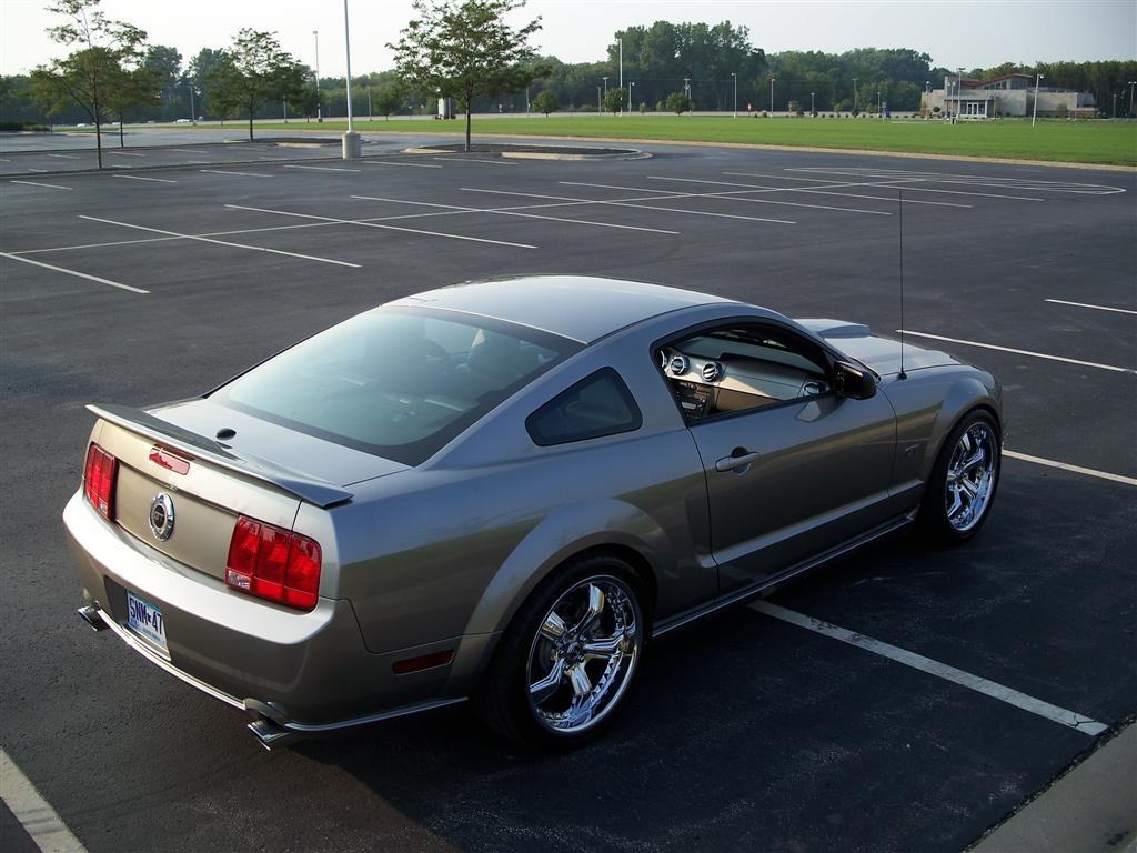

Install was very simple. You use two of the four holes used for the stock GT spoiler, plus the perimeter of the bottom is lined with two way padded tape. The hardest part is removing the stock one and the stock padded tape the factory uses. It helped using Goo gone. Then setting the new one in place would be easier with a second pair of hands to ease it down in the right spot. Very simple install.
As for the eBay spoiler from the spoiler store ... I think its very nice. It's blow molded plastic, just like the factory GT spoiler. Finish is very nice, paint was perfect. I'd definitely buy from them again. I wish they had the CS side scoops as well.

here's some pics, although not all that great ... the lighting was bad in the garage and it was raining outside.

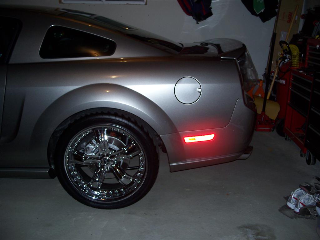

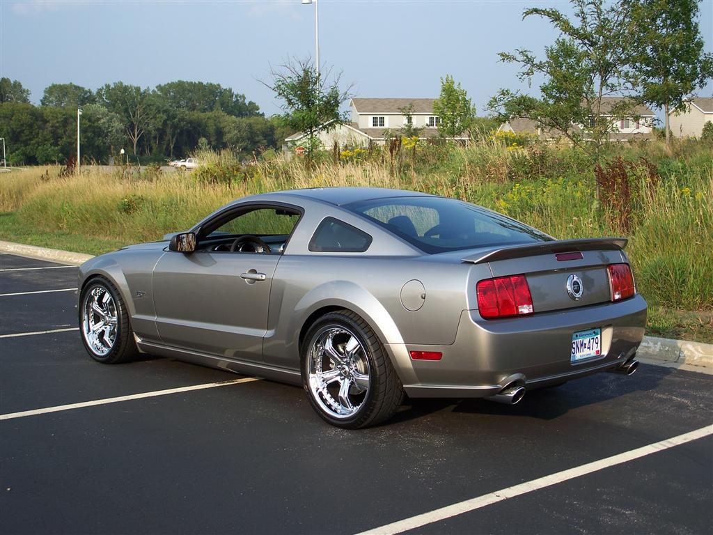

updated pics ... the spoiler store on ebay ... $120 to my door painted
