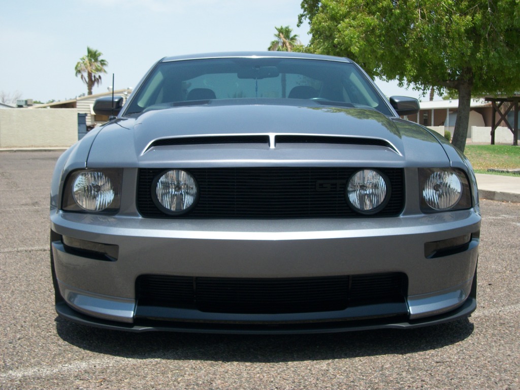

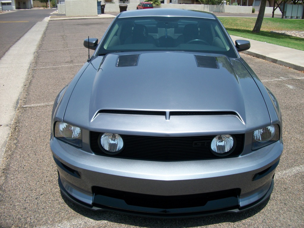

I did the trufiber Gts4 hood
This is a good strong hood. Good fit and easy prep, and because the hood is so strong I did not use hood pins this time. This hood fits tighter than the stock hood.
