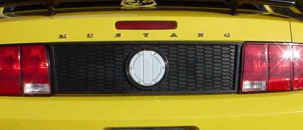

On my 06 I used one of those little "bent" flatblade screwdriver tools to remove the entire medallion. Marcello (of Silverhorse) said that if you gently pry near the keyhole, it will pull right off. I took his advice and it works perfectly. It leaves the adheasive tape in one peice and allows it to be reused. I do recommend doing it when it is warm as the tape will be more likely to release without tearing.
Hope this helps, here is mine with replacement medallion.

I wondered if I could "lift" it off, being careful of the paint of course. At least now I know how it's on there to begin with, which help a great deal!
