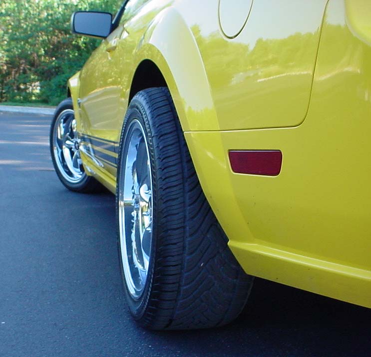

The 04 wheels will have less offset than the 05+ (approximatly +35mm on the 04 to around +44 on the 05). No matter what width / size, most likely they will extend out past the fender well.
Personally speaking, that was what I had in mind with my ride but while some really like the look (old skool muscle car) others scoff.... I think it looks cool and that is what matters...
Here is a pic of mine with 9x18" and 275/40/18, with a 1 inch spacer in the rear, from back to front showing the staggered look...
