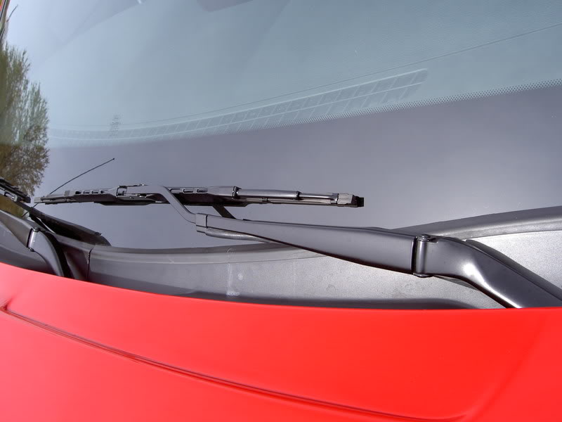

Anyone have this or know anything about it? I have an aftermarket hood and don't want to drill holes in it.

I relocated mine myself using the squirters off of a Ford SUV (Excursion/Expedition/Explorer) - I forget which one - if you want, I can get the part number off the baggie at home.
(Follow the hose under the wiper - the squirter snaps on to the arm - they were really inexpensive)

They're so relocated I can't even see them! Haha and yeah! I'd appreciate that!
The pack-rat in me still has the baggie - Part# F87Z-17603-AA http://www.fordpartsgiant.com/parts/...-17603-aa.html I think you'll need two. You'll also need to buy some hose and a hose coupling - available at any auto parts store.
