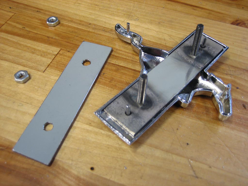

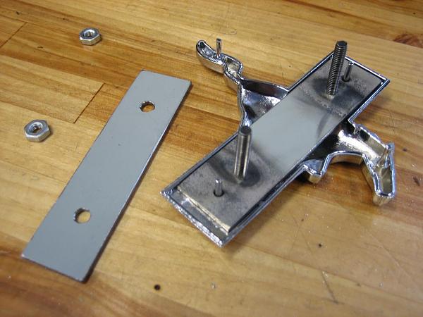

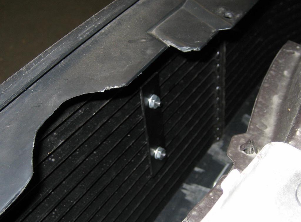

Originally Posted by Cowtown
Keystone which grille is that and is that an emblem added after the fact? If so how are you attaching it?
Sorry for the slow reply. I ordered the emblem from a 60's Mustang place (can't recall which one) and I specifically ordered a "grille emblem" but of course when it showed up it was a "fender emblem". I had to make up some bracketry to attach it because the pins were to short to reach through the slats in the grille, but it worked out good in the end.
Attached Thumbnails Black billet GT grille available soon (no pony or fogs!)-emblem.jpg   Black billet GT grille available soon (no pony or fogs!)-emblem-1.jpg
