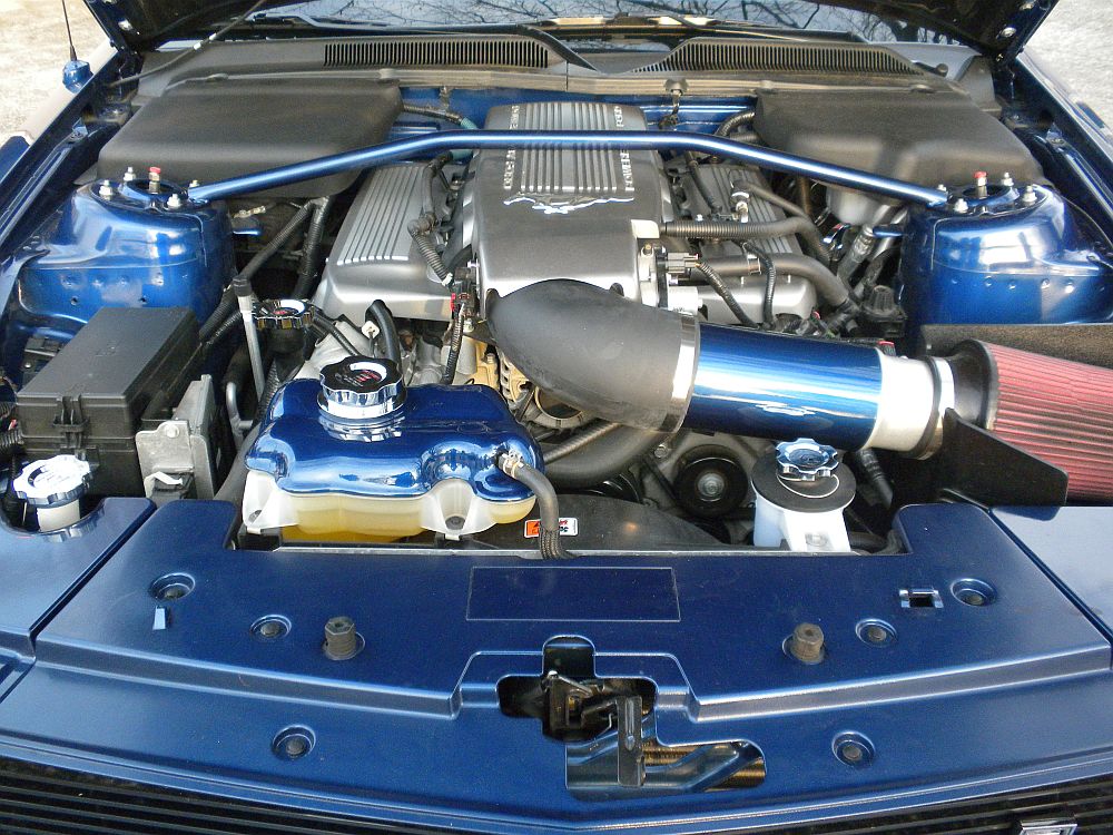

So how do you account for the hollow core of an aftermarket fiberglass hood? If you drill straight through, won't the holes be off?
I attached a pic of my engine bay too. Which panels get drilled?

On the hood - drill a small pilot to get where you need to be, when you're happy gradually open it up and then use a dremel as required to finish. Yes the hole will be at an angle to the hood when closed, but in line with the pins.
On the core support - use the factory bump stop locations, no drilling required, just patience getting the bottom nut into position (a long reach claw pick-up tool works well for this app). That's a big part of what took me so long to do it. Hacking up the back of the core support would make it easy, but not clean.
