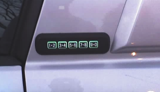

Finally got an RF keypad for my stang so I don't have to take my key into the water with me. This has a few advantages....no need to worry about ruining the key in the salt water...also don't have to worry about losing your key if you have it in the arm pocket or leg pocket of your wetsuit and you lose either your arm or leg to one of these incidents!

Here is a pic of where I mounted it. It works great!

Man thats cool looking, where did you get it and how was the install

They stick out too much. But an awesome thing to have. Had one on my last car got use to it after 10 years. But I have gotton into a car using them just running my fingers all across it hitting random #'s Kinda scares me.
If you have 1/4 window louvers I would stick one behind a louver if it fits.

Kevin Casey tracked it down for me. I have had a bunch of other mustang owners approach me and inquire how i got my stang with one...it is great to watch their face when I tell them I installed it. It actually was as easy as cleaning the area with the supplied alcohol pad and pressing it on there after it dryed. Took all of 5 mins. Programming was easy, turn your key from off to run (not start) 8 times within 10 seconds and then you touch a couple of buttons on the keypad, then push a button on each of your other FOB's and oua laa its done~!

Great idea, Dave. I didn't realize those were RF. I assume that means you can put it just about anywhere it'll stick.
BTW, how much did it cost, if you don't mind me asking.
