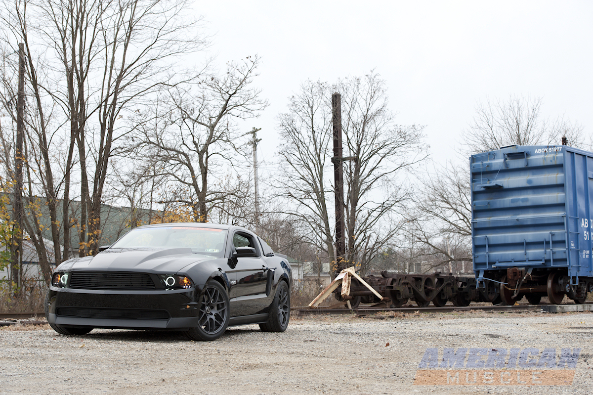

We currently run the 19" x 8.5" and 19" x 9.5" Charcoal AMR Wheels on the AmericanMuscle.com 2012 Mustang GT Project Car, Project Blackout. We've got 285/35/19's in the back and 255/40/19's up front. I think it's a pretty aggressive stance.

that looks great

**** u chris... I love the look of the front of 2010+
And I have a 07 so thank you for reminding me of my bad decision :-(
