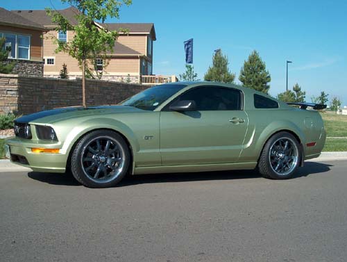

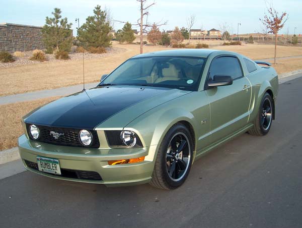

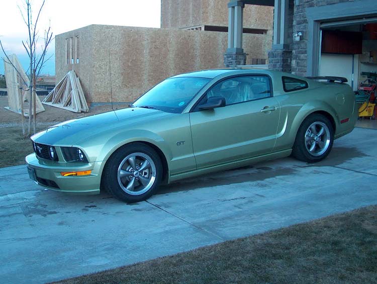

I've run 17's,18's and 20's on one 06 GT that I had.Once the car was lowered the ride went away.I don't know what your looking for in the bigger wheels but if its looks stick with 18's.If want handling run the 19's.What ever you do get some quality tires built in some of new side wall technology.(T/A KDW,Goodyear F-1)
Right now I'm running T/A KDWS 235/50/ZR18" tires on 18X8.5's(Konigs) and the ride is good,so is the handling.If at all possible try and get a wheel that is hub-centric if you run 19's.That way you don't have to run that little spacer that fits between the hub and rim.Here are a few pic pics with the different wheel combos I ran,all on the same car.
