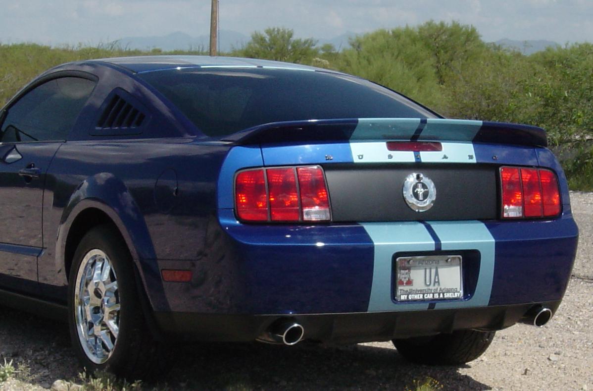

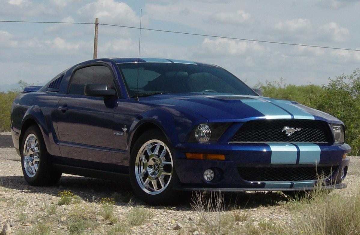

BTW, I did finally go to dual exhaust and found another damper on the muffler!!! And I did not sell the car as I eluded to on my last post on the linked thread. In fact, we ended up doing this to it:

Willie that car looks FANTASTIC!
You must have put SOME pile of money into it... weren't you saying you couldn't aford the gas? HAHA!
Major PROPS - I really like your choices of mods - you've got great taste!

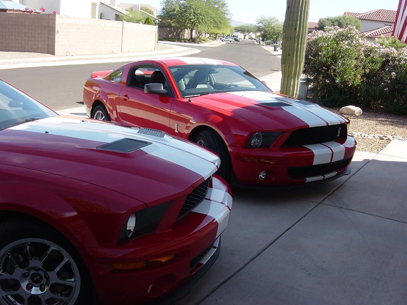

Thanks Rick. It was a long progression of events, from wanting to sell the car to where it is today. Believe me, it was not planned this way. Long story short: Only one week of owning the V6 was enough for me to say this car would in no way replace my '03 Cobra. Having driven a 390 hp / six speed car for years prior, I could not get myself to accept driving a V6 auto for my daily driver. So only eight days after purchasing the V6, I bought a red '05 GT. And instead of selling the V6, my wife decided she'd rather sell her mini-van!! Then I found this website (and 05stangKC). I bought all the GT500 conversion parts from him and installed them on my GT. Last year, I was very fortunate to have an opportunity to buy a new '08 GT500 for MSRP. When I explained this to my wife, she gave me to buy it..!! Then we had to sell either my 5-speed GT or her automatic V6. I offered to "give" her my GT, keeping our "twins" but she said she did not want a stick car for a daily driver. That sealed the fate of my GT (and retention of the sonic blue V6). Prior to selling it, I returned it back to stock, including the Whipple. So for a fleeting moment, we had two cars that looked like twins. Instead of selling my red GT500 parts, I painted them and installed them on my wife's car. That's how it came to be.

Thanks for sharing the story.. and again, your cars are GORGEOUS! The EPITIOME of a Mustang IMO!
