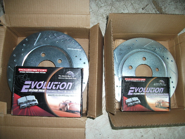

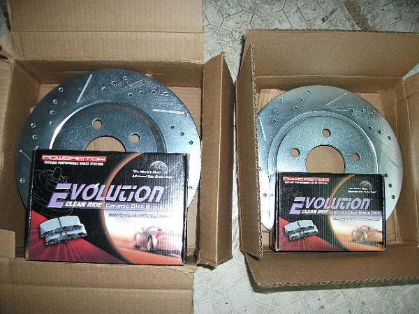

my dealer wanted $70 for the brackets. i got the kit from cjpony on sale for $125, brackets and rotors. i ran the rotors for a couple months but i needed new rear rotors so decided to replace all 4. i got 4 rotors and 4 sets of ceramic pads for around $205 from brake motove on ebay. ive bought 2 sets of these now. did the 06 last year, and this year i did mine. not bad for the money.
you can get the v6 set or the gt set, about the same price and free shipping. they got here pretty fast too. good service. this sale ended but it will get you to the store.
http://cgi.ebay.com/ebaymotors/Drill...item3369de2bc5

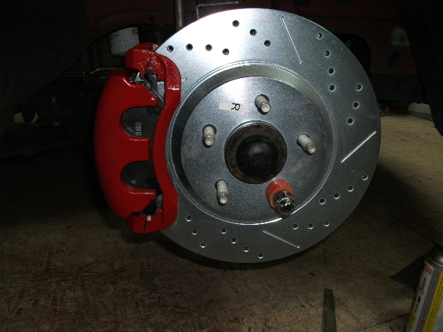

Old Oct 4, 2011 | 05:08 AM
  #40
GunnyFritz's Avatar
Joined: August 30, 2010
Posts: 169
From: Suffield, CT
Finally got them installed!
