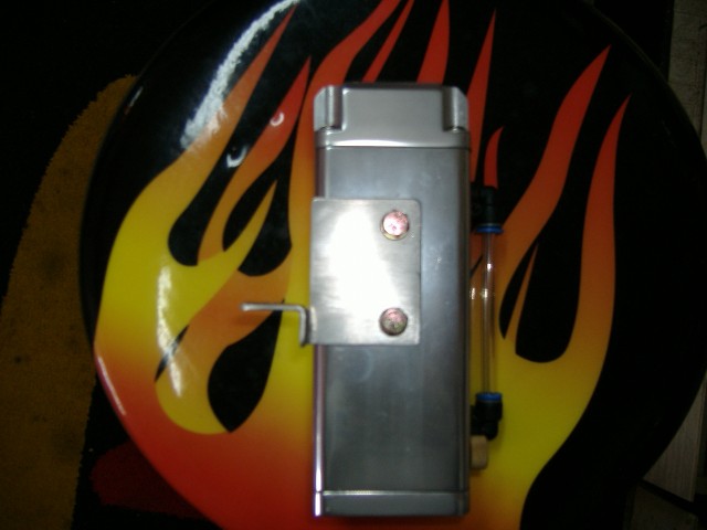

if anyone is thinking about doing this, getting the right can makes the install a cakewalk. the 1st can i bought was a failure, this 2nd can i got had the right size fittings for the right size hose. this is the can i bought off ebay.
32.00 w/ shipping
http://cgi.ebay.com/ebaymotors/ws/eB...=STRK:MEWNX:IT
the bracket wouldnt work, the blue hose is junk, but the can is real nice.

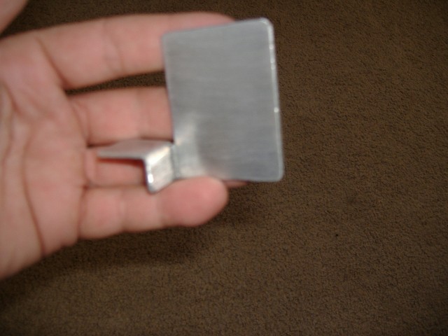

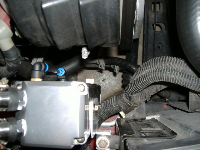

i got the 19/32" crankcase vent hose from oreillys. it comes in 20" pc`s for about 3.00 ea. watch though, i bought 2 pcs and they folded the hose into the box which made most of one hose kinked up scrap. i had to fabricate a bracket that bolted in place with the bolt from the computer, which is a perfect out of the way spot, and wide open under to drain to the floor.

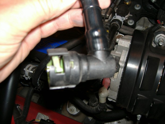

remove the hard plastic vent tube from the pcv valve and the intake by pushing the green button sideways and pulling off. i cut a slice in the hard tube to remove the 90 degree fitting to make the hose fit nicer to the catch can. the hose fit perfect on the stub out of the intake, the 90 elbow and the fittings on the can. a little teflon tape on the fittings, cut the hose and fit and clamp good. done. this should stop alot of oil from being pumped into the intake and throttle body i hope. now time will tell, testing 1,2,3

Jim brings up an interesting point. I guess an easy way to check would be to look at the existing connections and lines. If the driver's side is dry, then that tells us it is not important. I can see on the pics you posted that the PCV and the hose has some oil residue indicating the blow by.
