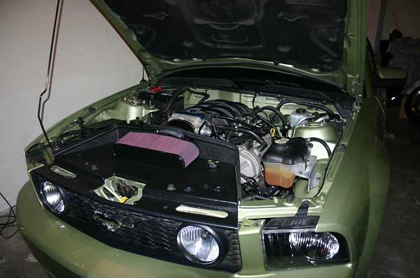

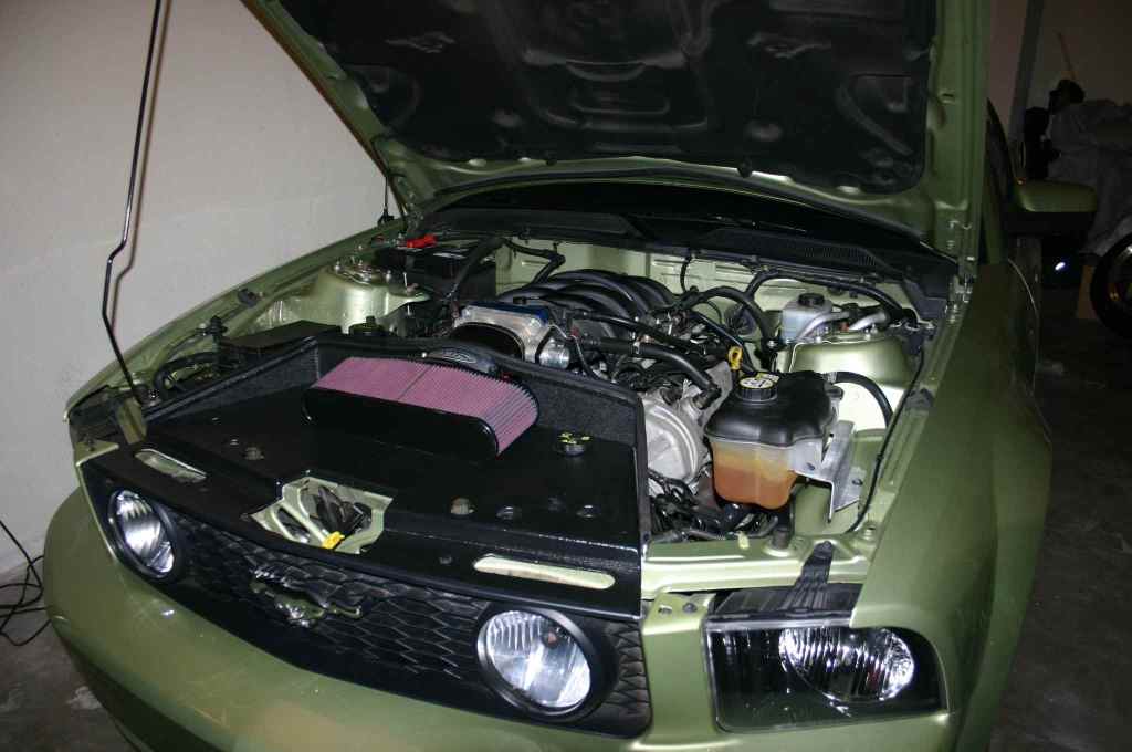

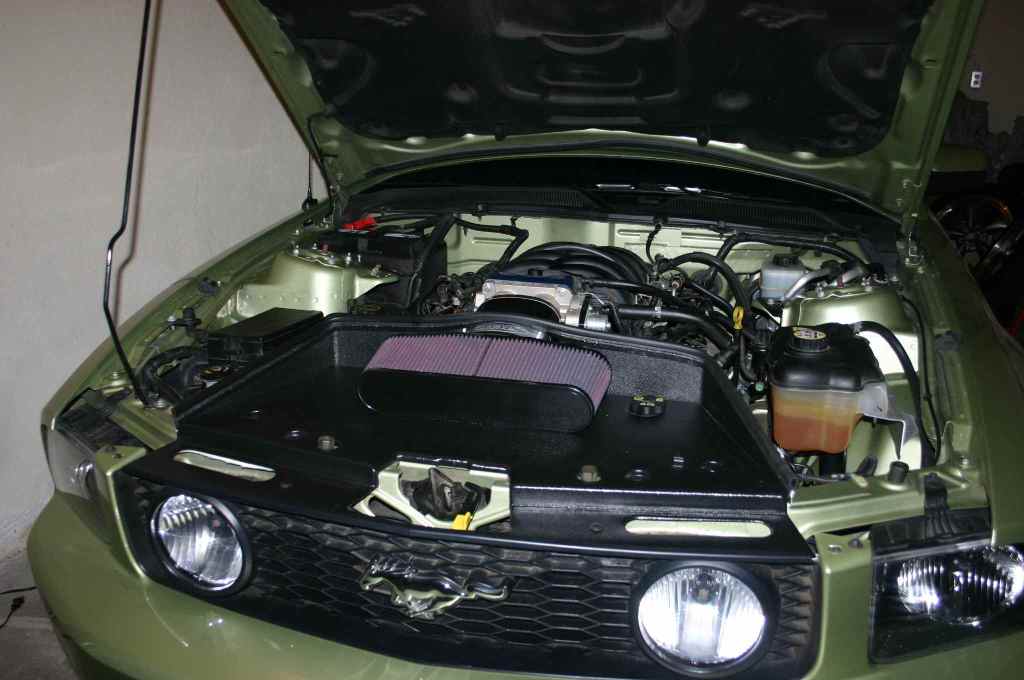

Here's the pictures... Someone asked about the color of the new Interstate battery, and you can see it's black, not green, though with a LL car, the green would have been fine for me...

Install looks nice.
What you may run into now is possible CEL's indicating that your engine is running lean. Unless of coarse you already have a tune for the WMS.
If you remove the fire blanket from the hood the WMS will seal better.
Have someone get in the car and rev the engine while your standing in front of the car. Makes one heck of a "suck'in" noise. Not to be confused with the "ram'in" noise.

Bought it with the Brenspeed tune and SCT Xcaliber 2, so no problems with CEL...
I'm not sure I see how removing the hood insulator would "help" seal it as it only touches part of the blanket now... That would leave a larger gap and thus more underhood air would get pulled in.
My turbo Regal got much louder intake-airflow-wise when I put the cold air system on it, especially under boost...
Mike E
