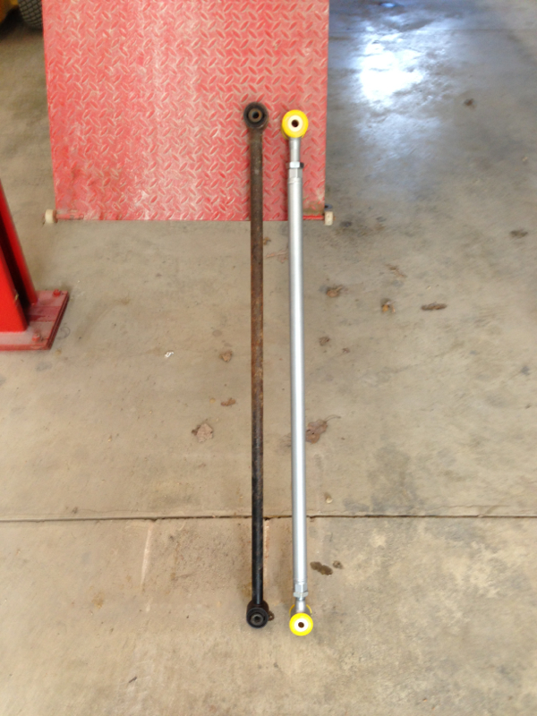

Look at the difference. Lol

Just lift rear a good foot or so. Two 18mm bolts I needed a long wrench to be able to loose. The very tight bolts. Pry out, pop in new one tighten to correct ft lbs lower car. Adjust measure and done.

That panhard rod looks just like the one I installed 2 days ago. I installed the J&M aluminum rod and the only difference I can see is my bushings are black.
You shouldn't have a hard time at all installing it, mine was a piece of cake. I did it at the same time I installed a new set of shocks, springs, J&M LCA and Whiteline panhard brace support bar.

completely different materials. WL uses a synthetic polymer blend bushing as well as chromoly, not aluminum. Not taking away from J&M at all, their product is great.
