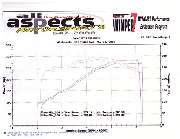

Now I know many dyno test after every part they install and as this is a good idea it's not a accurate way to test a product.
Cars will dyno different numbers on different days, so the only way to test any product is to do a base line the day your doing the install.
Here is a perfect example as to why.
Our shop 2007 GT was dynoed in March (55 degrees) and pulled 283 RWHP and 301 RWTQ.
Today in 95 degree heat it base lined 271 RWHP and 285 RWTQ. This is due to the heat and cars will learn when you make changes and make slight corrections, so you can not compair dyno runs from days or months apart.
So we pulled it off the rollers and installed the exhaust and then back on the dyno.
I was amazed it picked up a solid 5-10 RWHP and 10-12 RWTQ.:rock:
So with doing the base line the same day we were able to see a true gain. If we went off our last dyno run we would have been disapointed.

You are correct that the only way to compare mods is to do a pull...change to the mod...and do another pull within a couple of hours on the same day under the same conditions to get some kind of feel whether a mod is worth anything or not. Kudo's

Jay, if it not too much to ask I would really like to see the March dyno sheet also.

But if it's SAE corrected, wouldn't that account for the weather differences?

Gains if any from axlebacks i would just cough up to the dyno error.....same with this dyno 5-10 HP from and xpipe might be a bit much, but with a small amount of dyno error and that fact that you can dyno a can once, do nothing to it and dyno it 30 minutes later and the reading can be different by a couple HP pretty much means that anything is possible

Thanks for all the input.
I have not had the chance to drive the car yet, but my wife (who is not into cars ) says she can honestly feel a difference in driving it. That right there tells me we got a honest 10 HP. Most people can feel about 10 HP and up.
As for what made the power, this test took up enough time, I couldn't afford to do it for each part.
I think for the money (well under $500 for both) your getting good gains for as much as the just big name brand axle back price.
I was waiting for a Doug tune to come it, but it didn't make it in time. The car has a Evolution tune in it now.
The March graph is identical to this one, just boh lines are about 1 HP lower.

Good info. Thanks guys. About the GTA's, I didn't notice any gain by the SOP meter. But, 2-5 HP is hard to notice. Even 10 HP in this car is on the brink of noticeability. The dyno is the way to find out if you can play with it for quite a while before and after.
