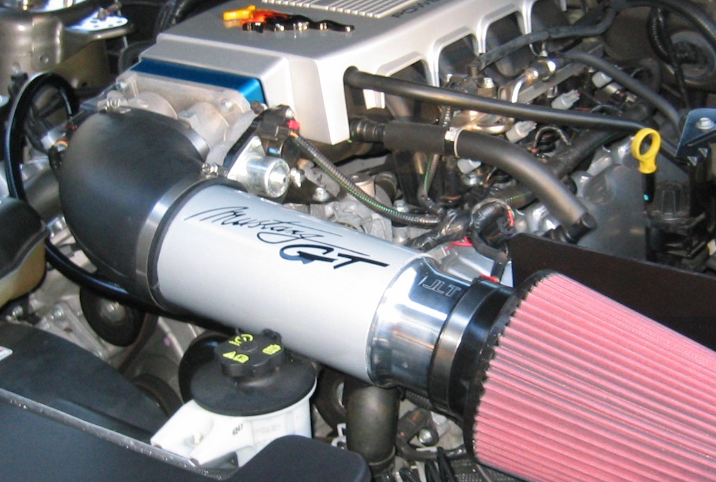

Mine is right up tight to the PS reservoir too. I trimmed the short end of the big hose as much as I dared when I installed the pipe. Then I put a piece of black self-adhesive felt (about 2" x 1" -available in any hardware store) lapped over the top edge of the back of the reservoir where the JLT pipe contacts it. This keeps the pipe from wearing on the reservoir and doesn't seem to cause any other issues. It's virtually invisible too! You have to look very hard at the attached pic to see the felt
Hope this helps.
Chris
