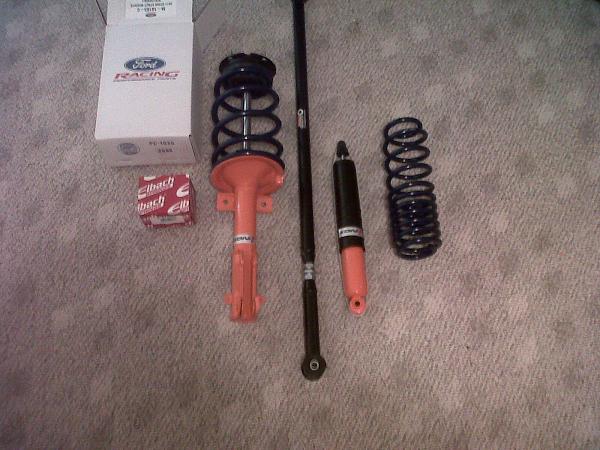

My Cs from AM will be here Tuesday. I have been getting clunk too so I am installing new everything (Koni STR.Ts, K springs, GT500 mounts).

Now the wait to get it into the shop. My friend's shop is swamped this week so I have to wait till next week to get this stuff on.
Attached Thumbnails Strut Mounts for 'Clunk' 8R3Z-18183-B or M-18183-C-ozark-20120703-00042.jpg
