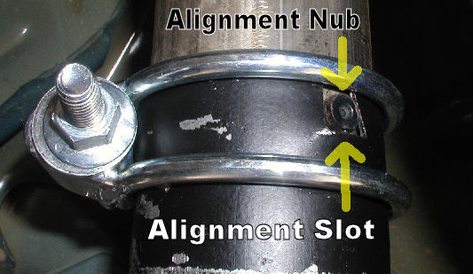

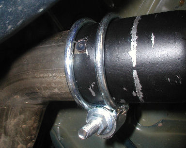

Make sure your clamp placement is like this (one leg of the clamp on either side of the alignment nub) and tighten them as tight as you can.
Attachment 2369Attachment 2370
Several of us TMSers have followed this pattern and have had trouble free exhaust systems.
I think THAT is my problem right there. My clamp is slightly before the alignment nut. Today when i fired it up before work, the right muffler was rattling again... and it really does sound awful until about 5 mins later when it warms up, then it disappears. I went out back and put my hand on the tip and the sound disappeared, so I'm almost sure its the clamp or a bolt to the chassis. When I get home tonight, im going to redo them both and push the clamps up some more, I'll keep you posted. THANKS!
Good point. Both of my clamps were right on top of that nub. My right muffler kept rattling and when I looked underneath, I saw that both were leaking. Un-did them, moved the brackets, and cranked them down. No more noise or leaks. Says alot for double checking your work...
Excellent!! the right one was making the noise, moved and retightend that clamp and all is good, for now.
So yeah Double check your work, and especially if you think you have the rattle in the Flows.
Thanks for the tip OKC, and chaulk another one up to the TMS!!

Redoing the clamp FIXED IT! However, I had to do it slightly different. I moved the front part of the ring past the muffler and onto the pipe, and the rear one was the one on the muffler. I did this so that it would slightly bend the tip and clutch onto the pipe like the one in your picture. The problem was the way it was clamped before, there was like a good 1-2mm space between the muffler and the pipe and it allowed for movement which made the rattling sound. Tightening the clamp just enough so that it held onto the pipe at the tip solidified that connection and now it sounds perfect. Thanks OKC
