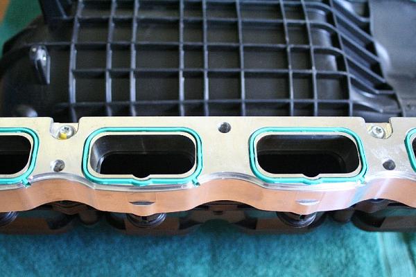

2 hours to install, I found it easy. Common tools found in most garages: 10mm deep socket, 8mm socket, 8mm wrench(or deep 8mm), Torx30, torque wrench.
One mistake: 89 lb-in. not 89 ft.-lbs. So I sheered the number 1 Intake manifold bolt. Ford will have one in for me on Friday.
Two question marks: The plates move around on the intake manifold before you tighten it down, so you have to port match, I hope I did it correctly. The billet ones have a little larger ports. Also the green seals were oily. I wiped them off, was that a mistake?
What would I redo: I failed to blow air around the engine before disassembly. I thought my engine compartment was clean, wrong. Daytona Beach drive comes back to bite me Dirt everywhere under the intake manifold.
Pictures are worth a thousand words...
1. You can see the oversized ports in the first picture.

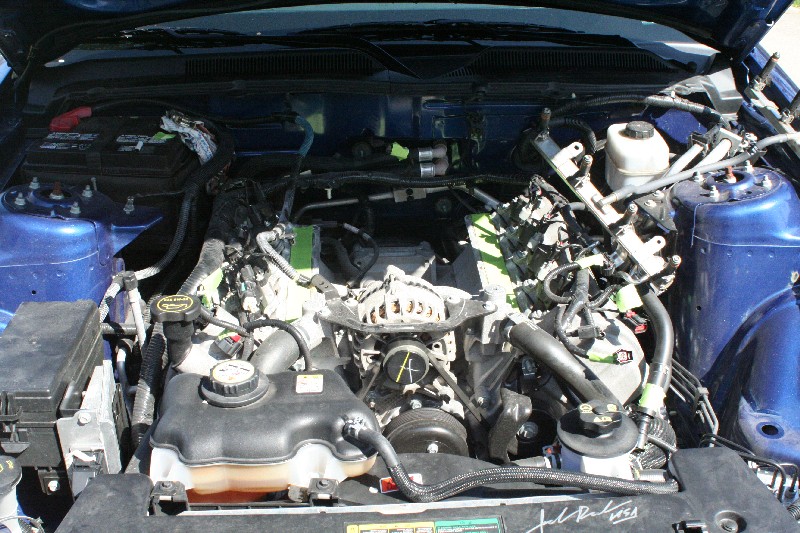

2. I wrapped with green painters tape all of the connections I removed. That way I would not forget a vacuum line or electrical connection.

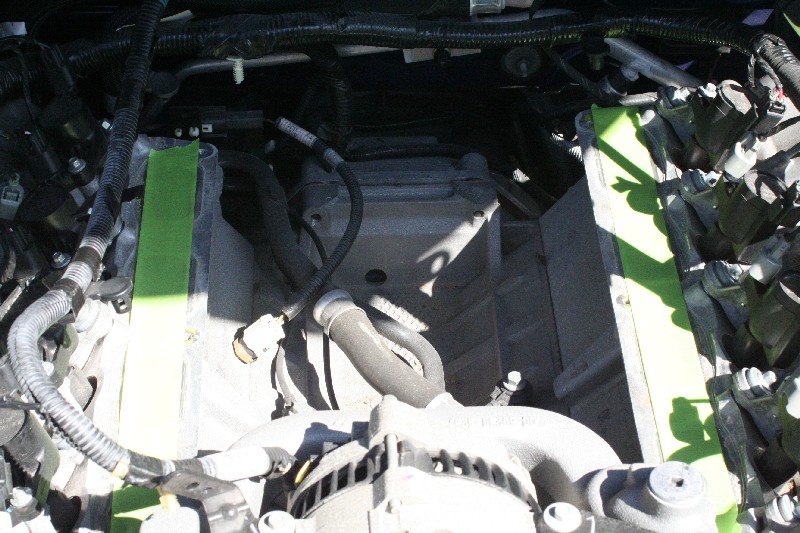

3. I also taped the ports to lessen the debris entering them.

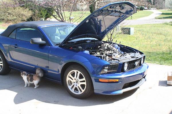

4. My cat decided to pose. Yes, I did this outside on my driveway, no garage

It looks to me like that you took some precautions on your install so I don't think I would be too worried about any dirt. And yes the plates float around within the screw clearance...so all you can do is try to even everything up to make it equal!!!
Scott
