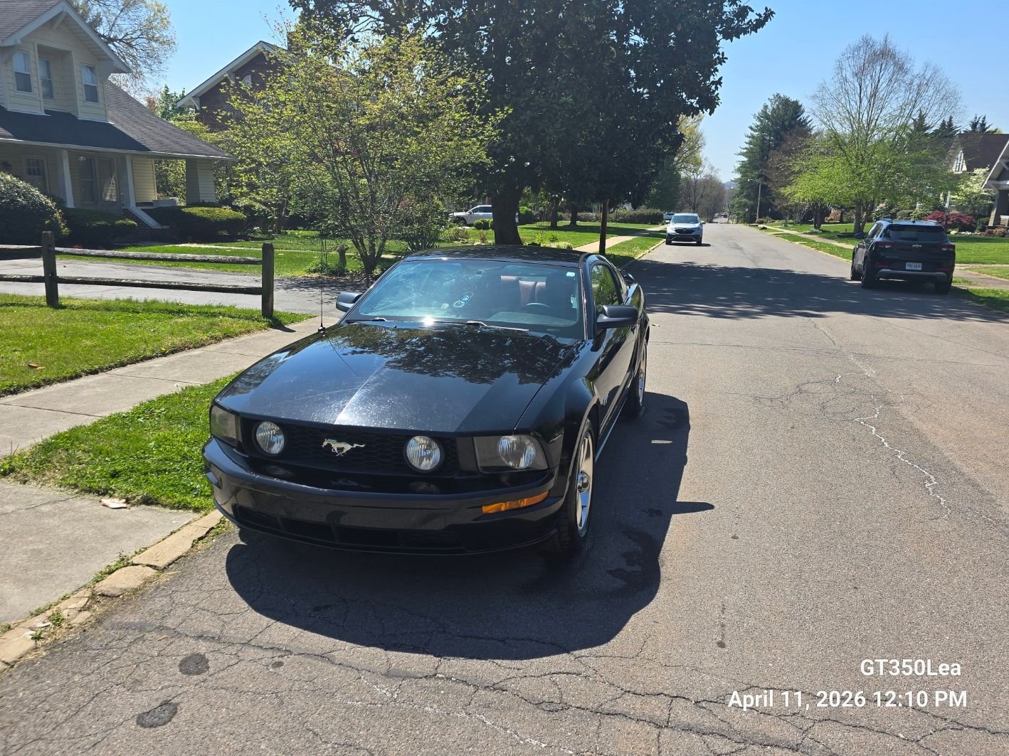

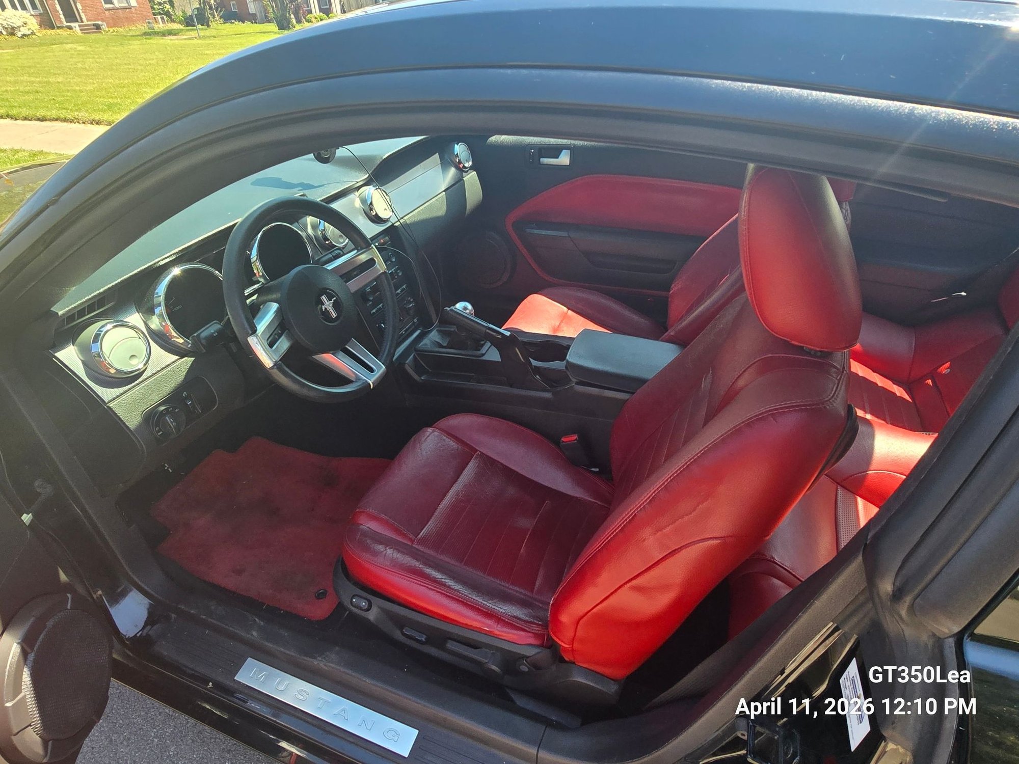

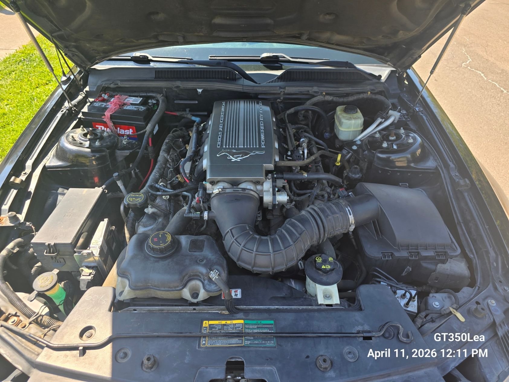

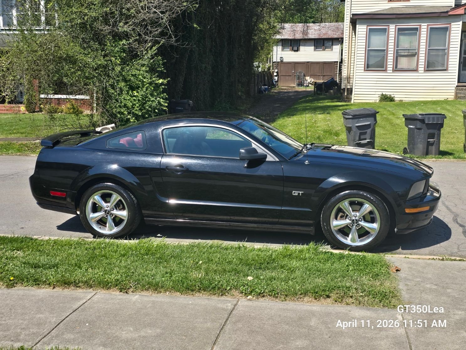

Not in too bad a shape (needs a paint correction for sure), wheels have a little curb damage, and the overall condition is about what I would expect for a 20-year-old car that was used as a daily with average ownership, previous owner said they had replaced the clutch but I suspect not the CSC (apparently that's what the cool kids call the slave these days) plus the shifter was worn out so that's been the first repair (went ahead and got a new flywheel, clutch and CSC along with all the bolts and the fluid line - trans does need to be rebuilt though, still notchy). Followed with new plugs and coils and when I get the chance I've got the 02 sensors, and fuel filter to install (already had some coils replaced but the rest looked OE and went ahead with the single piece Motorcraft plugs as I read the 4.6 3v combustion chamber is sensitive to plug type, idle is nice and smooth now), going to follow with new injectors and a few other tune-up items. Next up is the brakes, steering, suspension, tires and wheels. Bearing caps on the struts are shot so suspension is up next (going with the M-FR3A-MGTA kit) and I'll swap the control arms for GT500 units while I'm at it and the UCA. After the mechanical work it's on to the interior (had that up first but the trans in the GT and bearing caps on the GT350 needed attention and since I'm without a garage and needed to use a shop that sucked up my interior money - new seat covers and seat foam plus the driver's side power seat array). Also will be putting in the elbow grease cleaning things up and undoing 20 years of average ownership and at some point getting the trans and engine rebuilt.
