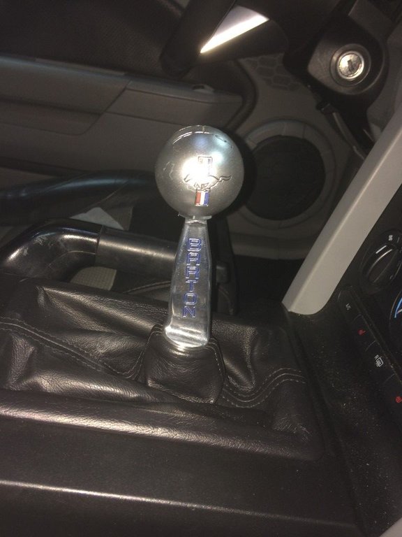

I have a Barton and I love it. A lot of people say that the MGW shifter is better. I have the flat stick. If you want to use the stock **** you would have to get the round handle.
https://bartonshifters.com/shop/ols/...m-style-handle
Barton vs Stock shifter.
I now have this **** from Nifty Shifters.

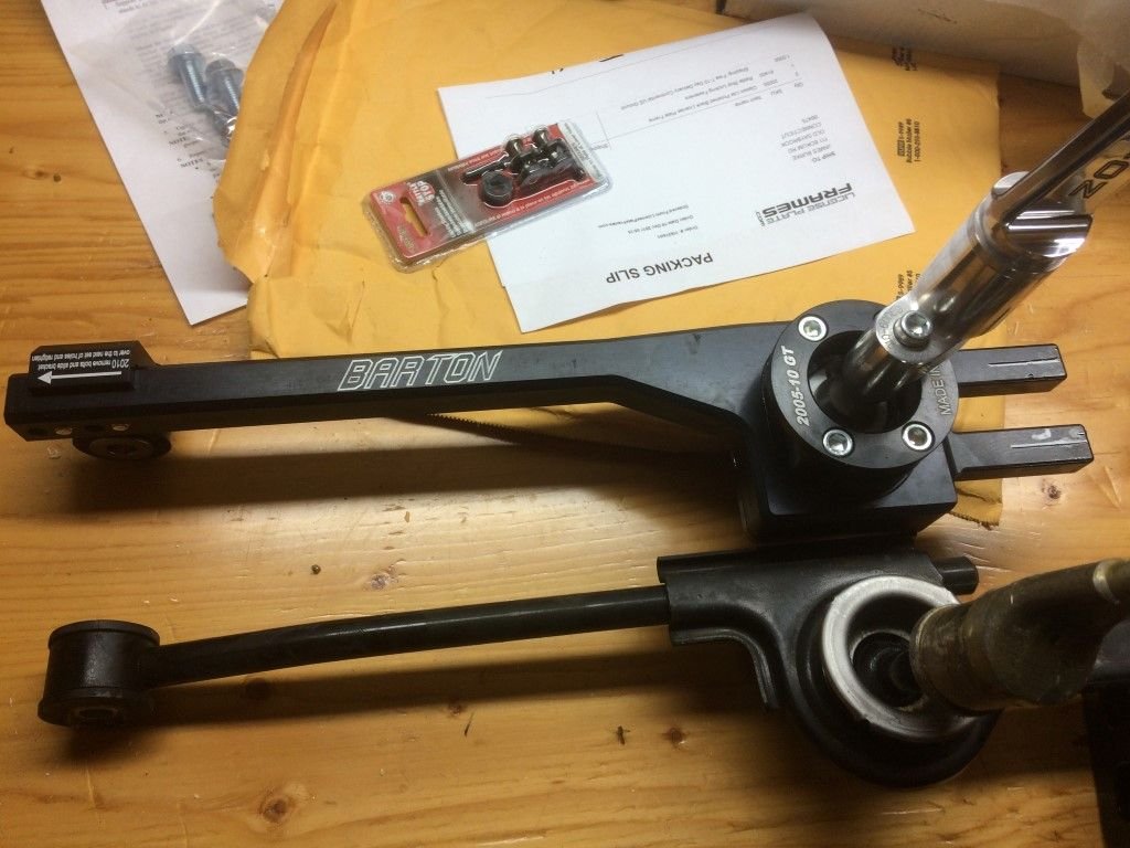

Shifter linkage
Ok well today I was driving my Gt to a golf tournament and bam the shifter flopped and was stuck in 4th gear, fun getting it home especially going uphill. Took both boots off and found that the linkage came apart. I was wandering if there was a simple fix to get by for the rest of the year until next spring. I'll attach a pic of what I found also I didn't get under it yet to really I investigate.
Old Nov 8, 2020 | 10:06 AM
houtex's Avatar
Joined: February 2, 2004
Posts: 7,648
Likes: 675
From: Insane
At first I'm like "How in the world did the thing fall off the shifter?! That's like... unpossible!
Then I figured out that the picture shows the shifter arm hanging from the shifter, and it's not attached to the transmission side. And then that got me in the right direction... and here:
https://themustangsource.com/forums/...ll-out-528329/
There's your problem. Your bolt fell out on the transmission side. You'll have to acquire a new bolt. This page on Steeda's website shows the bolt at the transmission side.
https://www.steeda.com/steeda-mustan...-555-7091.html
The three ways to get this is to go to Ford and order the bolt. Go to a salvage yard and acquire the bolt (and I'd get the arm, maybe the whole shifter, while I was at it). Go to a hardware store and have fun guessing which size it is. Whee and stuff on that one.
And when you put it back in, blue or orange threadlocker is recommended. Blue is standard for this kind of fastener situation, but this new orange stuff is supposed to hold like red but release like blue. I've been using it on my stuff, so if it doesn't do what it says, you'll know somewhere in here. So far so good, though, but I've not had to take the bolts out yet.
Anyway. There ya go! Hope you get it fixed soon!
